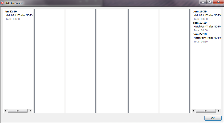

I started with a completely BLANK schedule... I went through every single block of the week - there was nothing in it.  I scheduled a 30 Ad (Match Point Trailer) to go out at 22.10 on Monday (Lun).  I pressed generate and it said 4 events were added to the schedule.
I opened the Ads overview as you can see and it has put the one I scheduled in on Monday and then rpeated it 3 times completely randomly on Sunday... 16.39, 17.10 and 22.18
This happens every time I schedule an advert - 1 in a block, 3 in a block - doesn't matter... it always adds in multipole recurrances in random times.  I have tried with a start date and an end date and without and its the same.  On this occasion I told it to schedule from TODAY until TOMORROW so nothing should go in on Sunday at all but it still did!

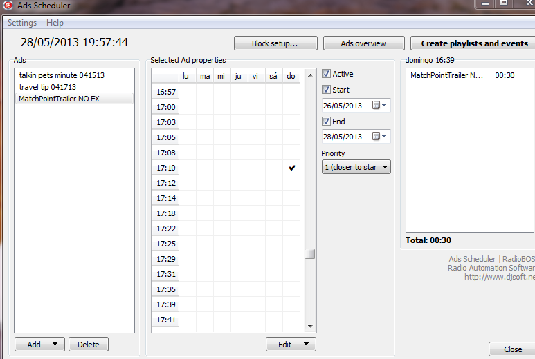

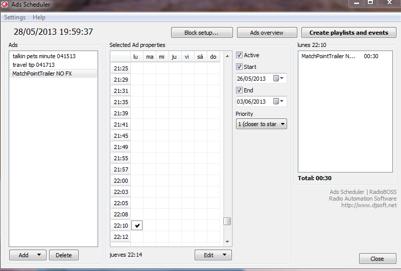

Can you please show screenshot of a main window with parameters for 'MatchPointTrailer' track?
Here is a shot of two of the blocks - hope this helps ?
I am pulling out my hair and only have 9 pieces of it left now!  I LOVE this software but this is my only bug bear!  Oh apart from one query but I will post that seperately!!
PS LOVING LOVING this software it compares highly with packages of much higher cost - well done :-)
