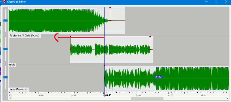

I have the idea to achieve something l
ike this:
The voicetrack starts at the exact second of the previous track, ending at the intro of the next track. This sounds very professional and there is no need for background music for the voicetrack.
By default the voicetrack starts at the Outro point and ends at the Intro.
Outro tag is not used by us (And I don't know how many people use it).
Manually this is possible with the following editor, but perhaps it can be a useful feature to automate (Option)
This is how Voice Tracks work in RadioBOSS - it adjusts mix points so that voice track ends when track's intro ends.
Exactly, except in the case that the voicetrack is longer than the into of the following track.
In this case the first part will be played silently, or with background music if this option is enabled.
What I need is for this part that exceeds to be mounted on the previous track.
Basically what I did manually with sigue editor

There is no way to do this without the outro point.
The problem is that we do not mark the outro point of the tracks, it is irrelevant. The only thing it would do is this, and anyway the outro is not something as clear as the intro.
Yes, an Outro point is required for this to work correctly. You can set those points randomly if it doesn't matter for you, like 30 seconds before the end of each track, this will probably do what you need (voice track overlapping a previous track and ending at next track's Intro).
I did the test and it is exactly what I need.
The problem is adding this song by song, I could do it from the api. But in the case of nonsense information: Is it possible to have an option to calculate outro points automatically for voicetrack?
Outro Points adds a graphic to the player interface that will be irrelevant
Automatic calculation of real outro points is somewhat complex, because it needs to detect where the voice ends.
I'll see if an option can be added to ignore Outro and simply play voice tracks so that they always end where Intro starts.
