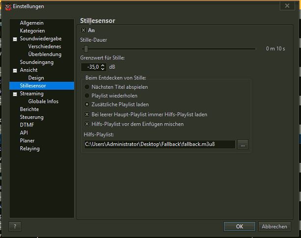

We use RadioBOSS on a Windows server to realize 24/7 automation.
To avoid possible gaps in the playout we use the silence detector and in case of emergency we let load a prefabricated playlist (fallback.m3u8).
If the playlist ends unexpectedly, the fallback.m3u8 is inserted and played correctly as intended.
However, if a song accidentally contains a lot of silence at the end and thus triggers the silence detector, the fallback.m3u8 is also inserted, but it is only played back on one side.
I can reliably reproduce this problem.

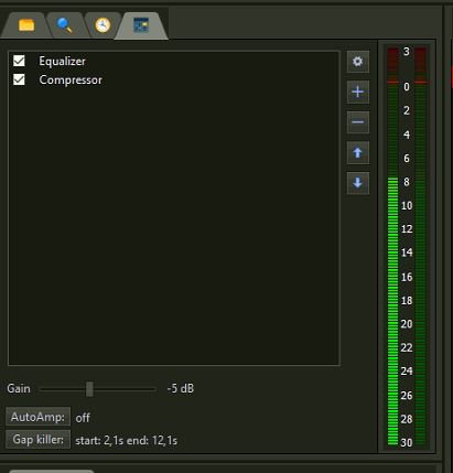

this has already been done. Nevertheless, there is the problem that in such a case the emergency playlist can be heard only on one side (namely exclusively on the left channel - see picture number 2).

  • If the silence detector triggers at the end of a playlist, the emergency playlist runs without problems.
  • However, if the silence detector triggers because a song accidentally contains too much silence, the problem arises that the right channel remains muted. In this case the playback is only on the left channel (see picture number 2). To fix the problem, it is necessary to restart the software.

The problem here is not with the emergency playlist, it's actually Equalizer bug, and it's fixed in the latest RadioBOSS 6.3.0.2 beta: https://www.djsoft.net/community/threads/radioboss-6-3-beta.11183/
