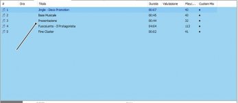

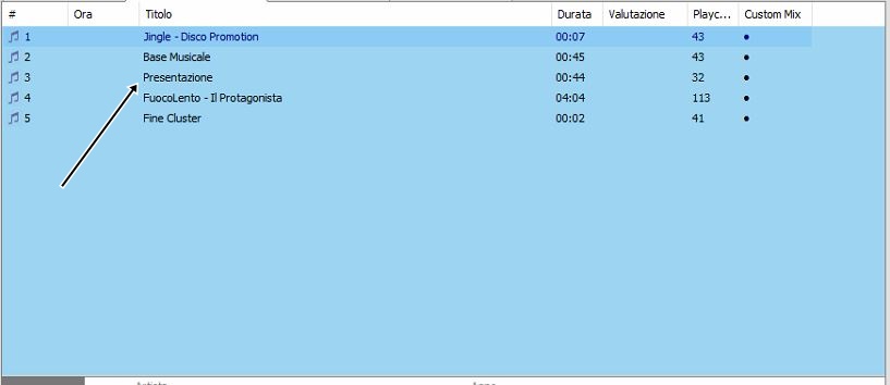

I often see that while the software plays this file, it stops. There are custom mixes, but I do not understand the problem because they never happened in the past  :-\
I downloaded version 5.6.0.1, it could be a bug that was not there before

Does it stop during track playback or at the end? If the latter, it could be that you have enable "Stop after this track" option (button located under the playlist).
Davide72 said:
I've seen the 2 files have different bitrates ... probable the problem is this
The bitrate, as well as file format does not matter.
I believe you will stop while passing through one file to another
But mixing 2 different bitrate files is perhaps a problem  ???
It could be that you have enable "Stop after this track" option.
No, bitrate does not matter.
No, i'm not enable "Stop after this track".
It has happened today even if it does not happen every time  :-[
That's odd... In this case more information is needed - how often does it happen, what RadioBOSS version do you use?
Happens during the transition between "Presentazione" and "FuocoLento - Il Protagonista",
In no other case, even if we use the function "m3u" and "custom mix" for other playlists.
I use RadioBoss 5.6.0.1 version

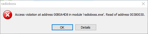

I attach the image of the error
Please install the latest RadioBOSS 5.6.0.2. If this continues, click the Details button and then "Send bug report" button.
