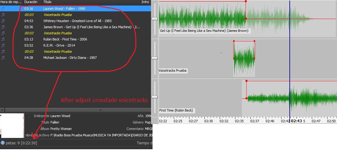

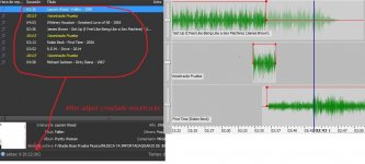

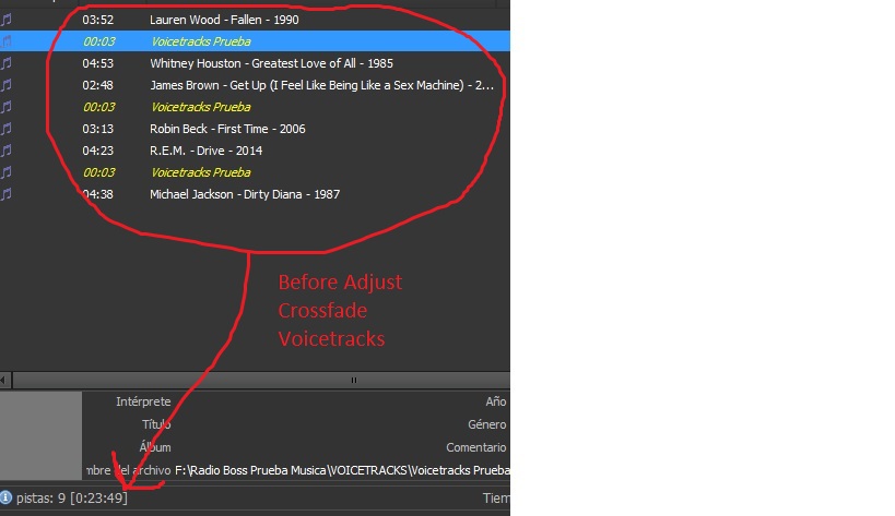

Hello!
When we do a list in the player with songs and voicetracks and save as a playlist, it loses the adjustments. He does not guard them and the duration returns to be as if it had not crossfade.
The duration of the playlist WITHOUT voicetracks crossfade is 23:49, whereas WITH voicetracks crossfade is 22:30
It would be very interesting that on having saved since playlist also he was guarding the adjustments of crossfade
We attach captures of screen. Thank you

This appears to be correct, as you moved the cue point in the track, and made it shorted. RadioBOSS takes into account crossfades when calculating the playlist duration.
Hello!
For example the duration of the playlist is of 30 min. When we fit the points of crossfade, the duration happens to be of 29 min.
The problem is when, we have fitted the voicetracks and want to guard them as a playlist, does not guard the crossfade since when we load the playlist the points have got lost of crossfade. For what the duration returns to be of 30 min.
Thank you
Currently there's a bug when crossfades are sometimes not loaded - we'll fix it in the next update.
