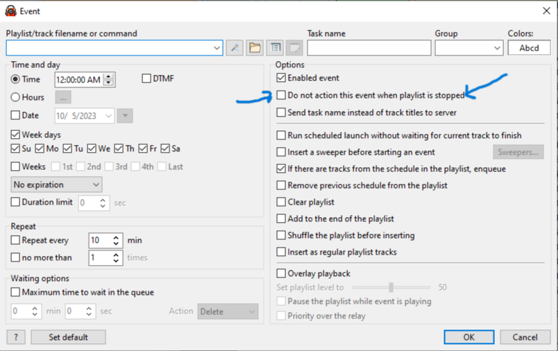

There should be a button that says "Do not activate when the playlist is stopped or the MIC button is on."
I don't remember where it is, but it's somewhere in RadioBOSS.
Await confirmation from the staff.
There's a similar option in the settings, but for when you press the MIC button.
I think it queues everything up, and then a simple NEXT plays everything that's accumulated.

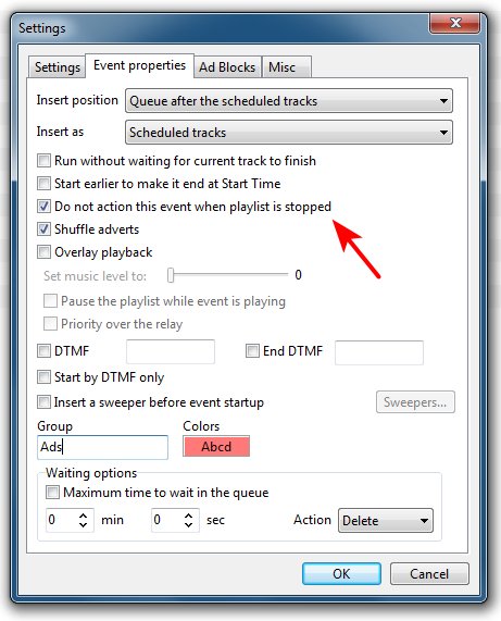

In Ads settings, there is this option, but it doesn’t affect the "insert stop command."

It seems that what you need is to enable the Manual mode in the scheduler.
You can also take a look at the "Do not start any events when the playlist is stopped" option in Settings, Scheduler.
Unfortunately, no, it does not queue - I have added it as a future improvement, it will keep track of "skipped" events (Manual mode and options like "Do not start when MIC is on" and others) and you will then be able to launch those events from there.
