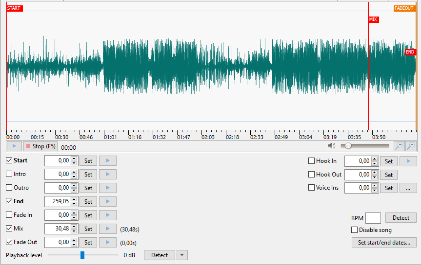

Hi!
I have a problem with weird latency when starting a new track.
I'm planning to include automatic DJ Mixes in my rotation.
But even with perfect beat synced songs and calculated mix points (30,48s = 64 beats/16 bars with 126 bpm) i can't achieve a good sounding transition.
What's weird about this is, the delay seems to be a random.

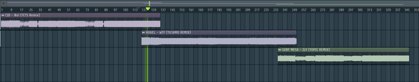

I checked the tracks by putting them in FL Studio and they are fine.
At this point i'm very frustrated, is there any information on why this happens and how this can be fixed?
This is the audio from FL Studio: https://we.tl/t-qRv3Wtr1ag
And this is in RB: https://we.tl/t-5nX5t41T5g
Can you please specify what RadioBOSS version do you use? The versions before 6.0 have a margin of error about +-100ms for MIX and other points. The 6.0 improves it a lot.
For me personally, i think zero delay could be a gamechanger for RB.
This is currently the only thing holding me back from using the program to its full potential.
I'm not sure it will be possible to improve it further. Currently the mix/fade positions are based on sample size - that is it can be delayed by up to a sample size.
