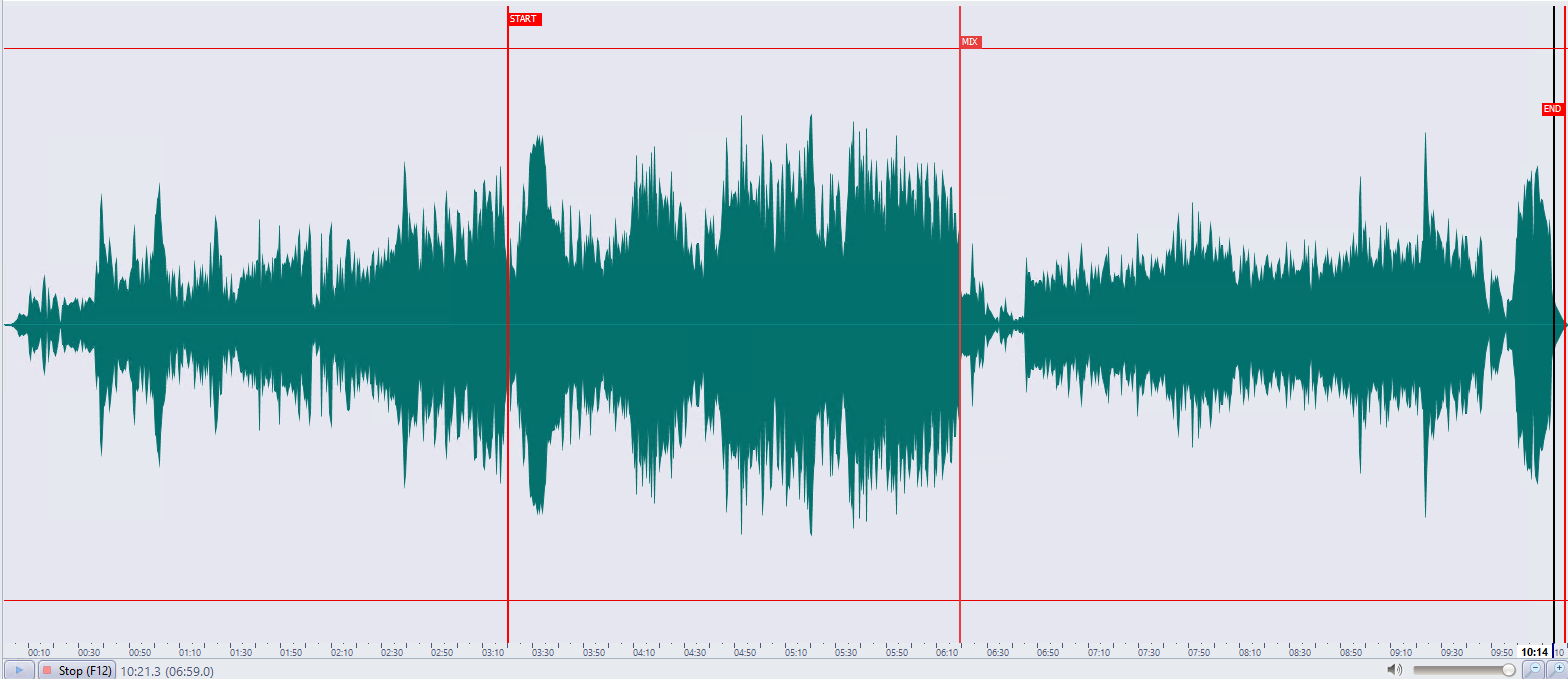

For End point etc my question is because some live titles are like this :
Should I move the end point near the mix to avoid PLGpro problems ?
Best
I think in this case Pl generator will consider 7 minutes duration because the end point is at the end !
No, it'll consider Mix as track's playback end point.
