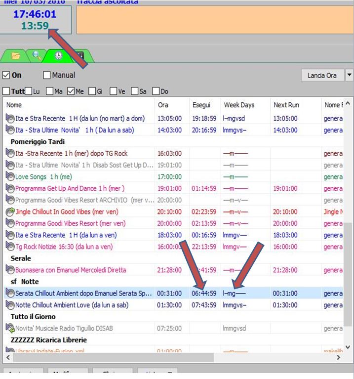

Maybe a bug in RadioBoss in schedule: Mondays and Wednesdays I planned an event at 0:30, only these two days this event will not work if we approach the now 00:30 where it needs to activate work for example 5 minutes before the desired time in timer column indicates 23 hours before activation for this event does not work.
If, for example, add another day Monday Tuesday Wednesday even then the timer works properly.
Hello Dmitry
Thanks as always for listening. As we see, very clearly, if the event is scheduled for 00:31 only days Monday and Wednesday it will not work, the timer is turned off. If I add another day (I do not need in this case) here is the timer appears and countdown and 'active, if I remove the day Thursday the timer disappears. Same thing to Monday, if I add on Tuesday (I do not need) the timer is activated and then the event will run. Only difference I can not prove because it occurs late at night, when we approach the hour that should work if there are only two days Monday and Wednesday will indicate the timer function 'but' at 00:00 Activation, then Monday night will remain inactive. I hope I was understood.

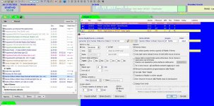

Can you please also post screenshots of the events themselves (the event window)?
Hello Dmitry
I hope you have understood what you asked me. Let me know if ok
The error doesn't reproduce here. Could it be that you set the event to run at Monday, 00:30, but if it's a Monday already, daytime, the "upcoming" 00:30 is actually a Tuesday?

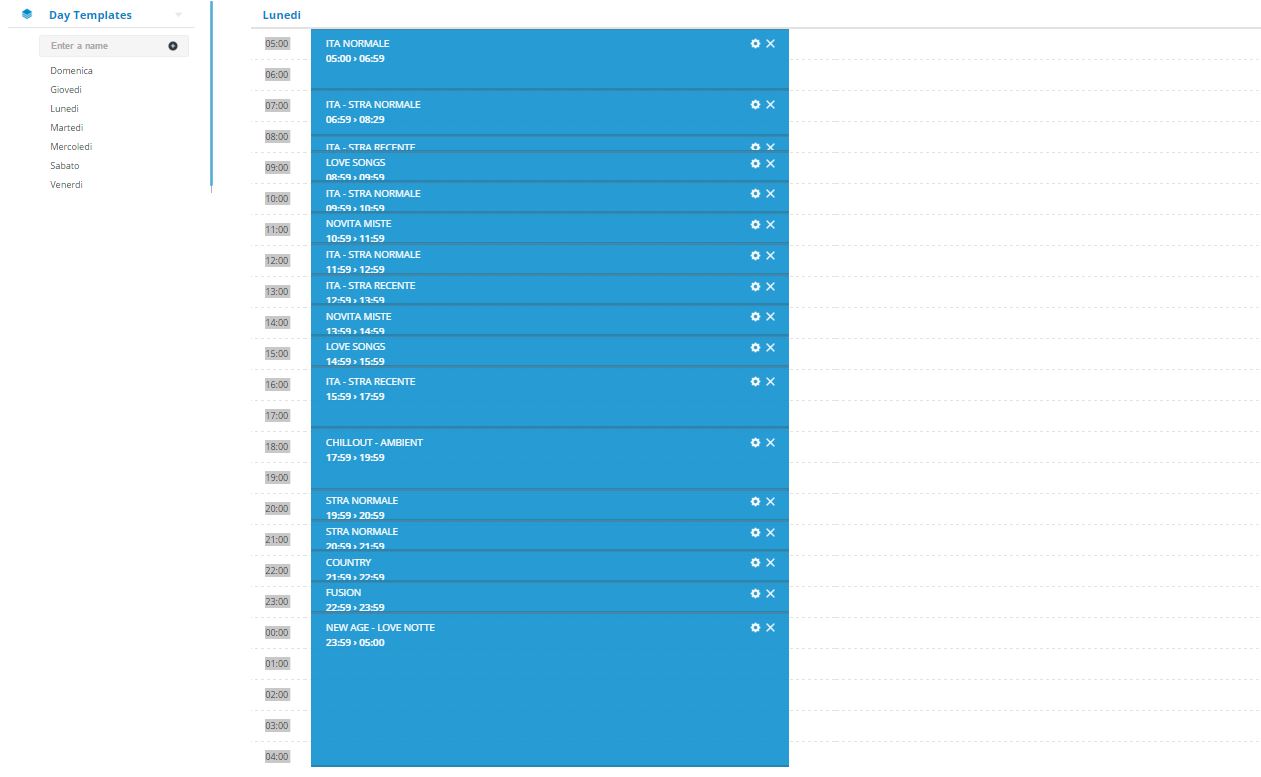

Briefly, the schedule must consider the change of day when they begin the programs of the next day (eg on Radionomy to overcome this problem consider the new day from 5 am, and their name is DAY TEMPLATES as see in the picture).

On your screenshots here https://www.djsoft.net/smf/index.php/topic,4525.msg21563.html#msg21563 it's working correctly: it's Monday, 17:45 and your event is set to Monday, 00:30 - this means, the event was started earlier this day, and it's not going to start later at 00:30 because it's not Monday anymore - it would be Tuesday.
