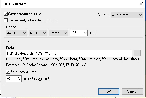

Hi Chris have you tried the option to split recordings ?? I do not know if it will play with the scheduler command though. We also experience problems with recording. We trying now to have a separate task with one command "streamarchive 7200 <filename>" starting at the same time of the task needing recording. hopefully we will not have all the other strange behaviours.
Cheers
Jose
