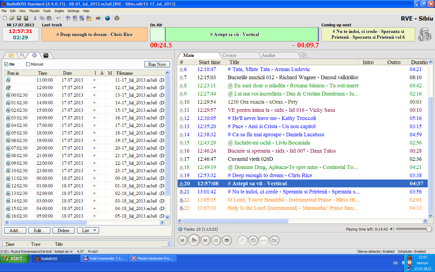

I suggest to make more playlists wich start at specific hour as EVENT in Scheduler. That's becouse from Thursday until Saturday is possible to have a PC crash or any other crash. I usually work with playlists by four hours and in general settings is activated "Resume Playlist". Unfortunately right now RB 4.9.0.11 has a "Resume Playlist" bug.

At my job (http://rvesb.ro) I make playlists by 1 hour and I load them in Scheduler at the right time, like in image. Do you want something like that ?
I just need a way where I could insert my after dark playlist and have it start at a certain time and end at a certain time and have my daytime playlist take over.

O.K.
Take your time and study all these steps:
Step 1 :
http://manual.djsoft.net/radioboss/en/using_playlist_generator_pro.htm
Step 2 :
http://manual.djsoft.net/radioboss/en/scheduling_playback.htm
Step 3 :
http://manual.djsoft.net/radioboss/en/automatic_playlist_generation.htm
After that you will be able to make any simple or sofisticated Schedule.
It is recommended to make the playlist a litle bit large. If it has 16 hours, make it by 17.
Why ?
Sometimes a co-worker (you, also) can delete a track from the folder, but in the playlist the track stil remains. RadioBOSS find that the track is not in it's location and playes the next track, BUT that means that your playlist is shorter with 3-6 minutes. If there are more then one track missing, than your playlist is cuted with the sum of missing time of the tracks.
So, make the playlist larger.
RadioBOSS can start a playlist for you at specified time - use Scheduler to do it. Make sure the playlist is long enough to fill a time frame.
There are several ways to end a playlist: start another track/playlist/URL/... - just create another event which will start another playlist. If you want to just stop playback - create an event with stop command.

The one problem I'm going to face with the night time playlist is that it's going to be longer than the time slot.
It's not a problem - you should have an event which starts a day time playlist.
