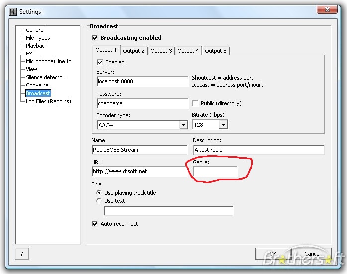

Thanks for the update! But I don't understant, how genres could interfere with broadcasting... Could you give more info on this please? How much genres did you have when it didn't work, and how you reduced the number of genres.
Well,
I'm at work so this is just a guess, but i had a full list of genres, country names, tags ect.. under genres. I would say 15-20. I erased all of them and left out two to test it and it worked fine. I kept adding an extra one testing it out each time until i got that error again , once i got the error just reduced one. I was able to fit quite a few, but I am pretty sure it is the number that affect it. I am sure if you try this out on your end you will find the same issue. Add a bunch of genres until it won't want to connect
Yes, I'll check it. But I don't understand where are you adding the genres? Could you please post a screenshot of it?
Thanks.
Thanks.
I am not at my computer now for screenshot, but no need, I have attached a random picture of radiobos and i put a circle of where i insert the genres, picture is of an older version but not much different.  I just put them like this "pop, rock, country, latin, europe, south america, latin, ect....    I put a lot fo them and had issues connecting or starting server.
