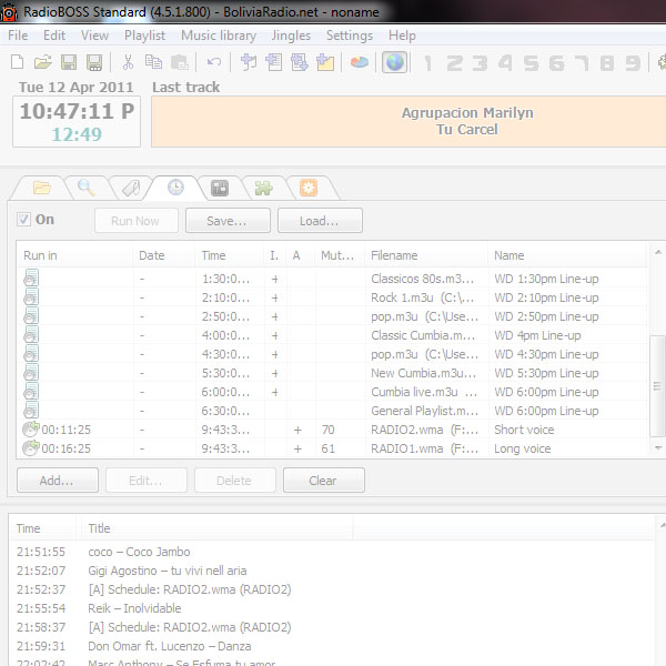

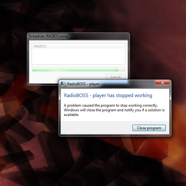

well, you guys still havent fixed the "play above the air" feature  :mad:
I downlaoded the one from the download page, and left it on. I woke up and checked my pc, and what do you know, the same issue......
When will this be fixed????????
attached are screenshots of crash
attached screenshots of crash
