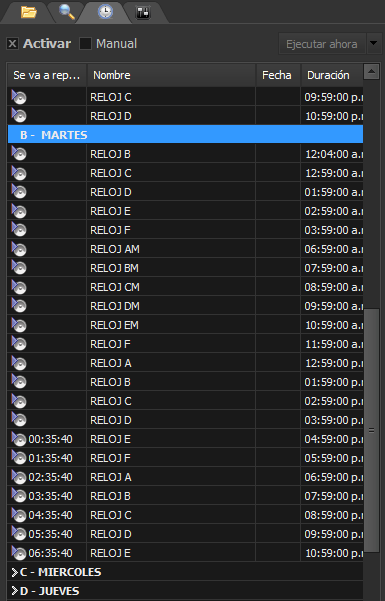

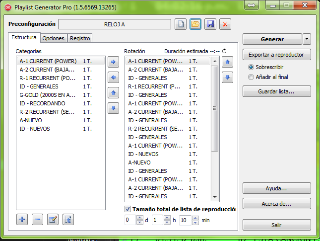

With the playlist generator PRO, I make all my structure and through the events I generate the automatic playlist every hour.
attached photos of one of the structure of how I have armed in the generator and events

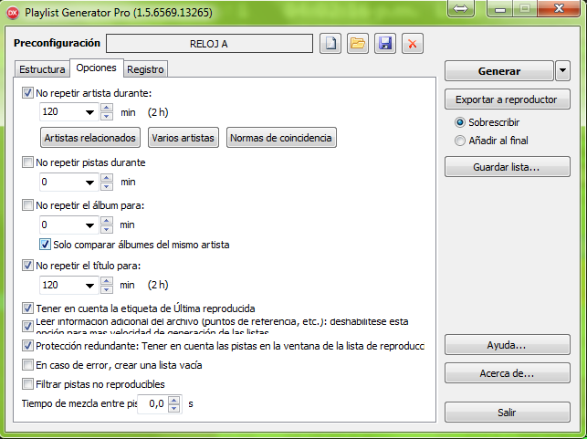

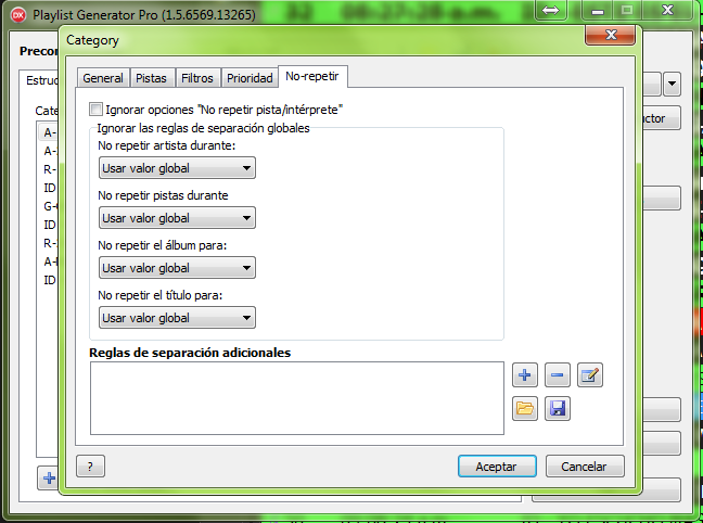

The settings appear to be correct - also make sure that you don't have repeat protection rules disabled in the category settings.

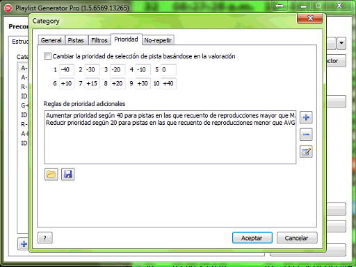

Hello, if I use the latest version of beta radioboss, I will attach some photos of that section to see how well it is. What I do not understand well is how to place well in the rules of priorities, and what options are appropriate or so that each of your options works and you can place an appropriate configuration, I do not know if the options of the additional priority rules are well done
Of the rules of priorities and of the option not to repeat.
Thank you
There's no correct or incorrect way to set priority rules. You add the rules to adjust the playlist for your needs. For instance, increase priority for tracks that were not played recently.
The settings are correct. It should not repeat tracks in this case. How often do you see repeats?
