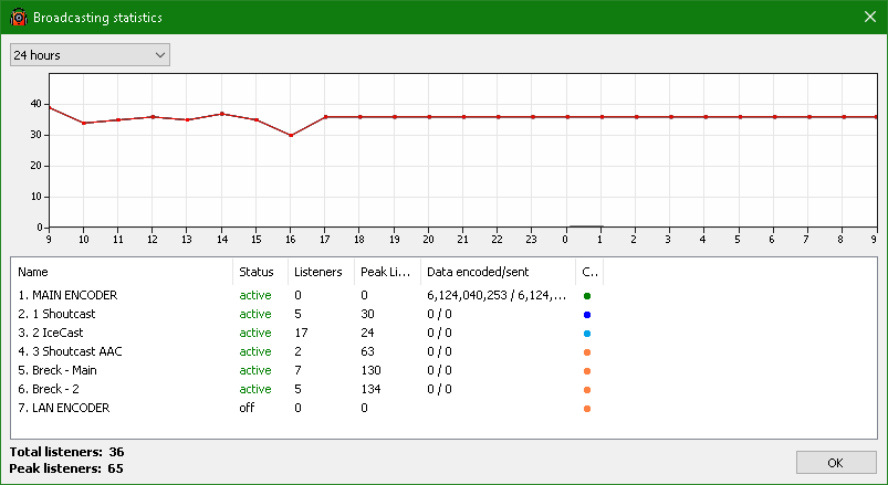

Strange:
All day I've been seeing the same number...
All relays were connected and active.  I checked the server, all was good there.
I tried to turn off/on encodeers.  the number dropped to Zero and stayed there.
The only thing left to do was to reboot radioboss  :(    After that, all started to work.
That is quite weird
When this happens, please open statistics window and check if there are any error messages in the table.
I did that
I did not see any errors... all encoders ans relays read ACTIVE in green.
The numbers were not refreshing, that's all - no errors
In the log no errors as well.  :(
All looked just like on this picture.... just straight line throughout all 24 hr frame with one stuck number of listeners.

While we were unable to reproduce it, we'll add more checks for such cases in RadioBOSS 5.9, making such a situation less likely.

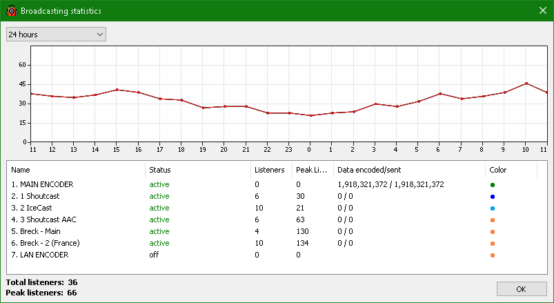

Here we go agan... 24 hrs number 36 is stuck.  I do not understand why this is happening?!

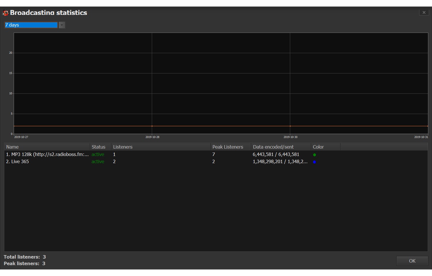

I can say that I also have experienced the statistics problem as well.  Mine statistics issue is with my Live 365 encoder and it has stayed stuck at 2 for weeks.  I have halted the program (5.8.3.1), restarted the PC and reselected the choice to get the statistics from the Broadcasting Server.  None have changed the Live 365 Stats.
