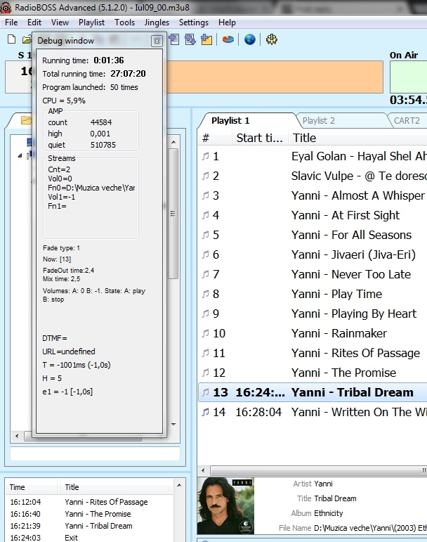

There were no changes in audio engine in this update. Please try restarting your PC. If the problem still exists, click Ctrl+D and make a screenshot when the sound level is low.
Did it. I'll try to see on other PC's.
OK. If it still doesn't work please post screenshot of a Debug (Ctrl+D) window, probably it will shade some light on the issue.
The same situation: very low sound level.

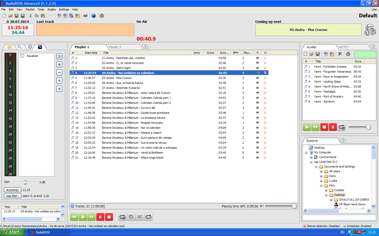

I tested on another PC (Windows XP SP3 Pro - Licensed).
There is THE SAME PROBLEM with the sound.
AND another one: GUI issue (see the image)
It looks like a problem related to Windows XP (we do not test minor updates under Windows XP). Thanks for updating.
