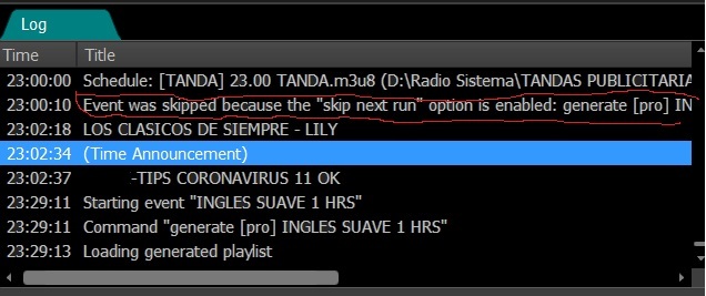

Hola, tengo este error de forma regular, no carga la lista de canciones.
¿Cómo se puede solucionar?
Gracias.

Hi, I get this error on a regular basis, it doesn't load the song list. How can it be solved?
Thank you.

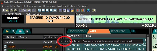

This is not an error. It means that you have started the event using the Run Now button and therefore it skips the next scheduled launch. You can control this using the arrow button near the "Run Now" button.
