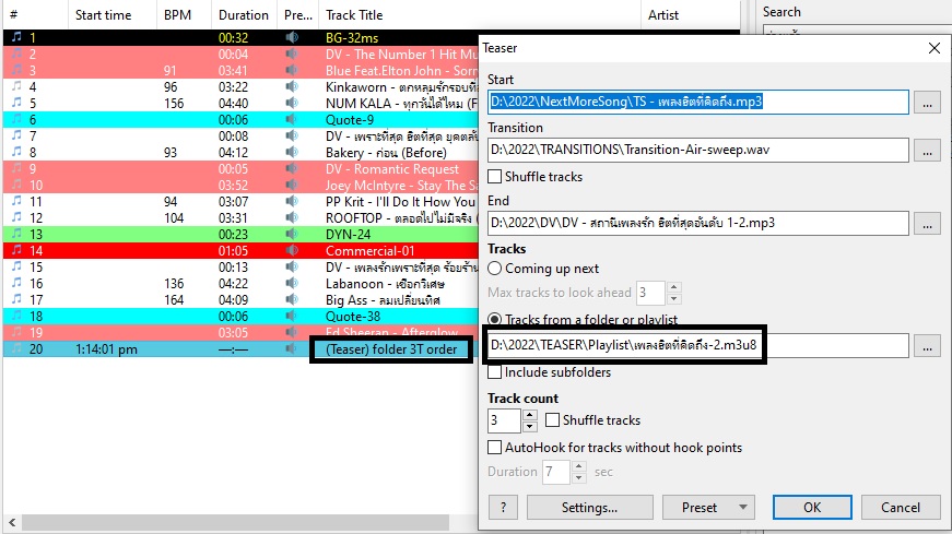

sakda.bumroongtin Member Apr 14, 2022 #1 I'm use V.6.0.5.5 and Add Teaser 3 song by my play list .m3u8. Could I random 1 song from my play list to play after Teaser end? and may be sometime Teaser dubplicate same song. Thk. Attachments teaser.jpg 140 KB · Views: 251
D djsoft Well-known member Staff member Apr 14, 2022 #2 You can create a playlist with two items - a Teaser and probably a Track List item to select a random track: https://manual.djsoft.net/radioboss/en/using_track_list.htm Then you can schedule and start this playlist when needed.
sakda.bumroongtin Member Apr 15, 2022 #3 Thank a lot and have a great day! djsoft said: You can create a playlist with two items - a Teaser and probably a Track List item to select a random track: https://manual.djsoft.net/radioboss/en/using_track_list.htm Then you can schedule and start this playlist when needed. Click to expand...
