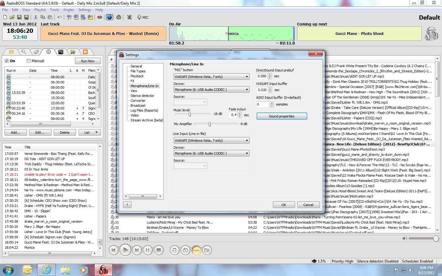

I am using a Yamaha MG10/2 sound board and a USB Behringer U-control UCA202 for my soundcard...when I stream music through RadioBoss everything sounds fine but when I try to broadcast live and use mic then there's an echo (on mine and the caller's end), there is static when it's silent, audio cuts in and out and sometimes I get feedback in my headset...I have to close RadioBoss reopen it or turn the mic on and off to relieve this problem... what is causing this problem and how can I get a clearer broadcast?
To get rid of echo:
open Settings->Microphone/Line.IN and turn on the "Disable local echo" option.
I don't have that option
With "disable local echo" option enabled, you won't hear microphone through speakers, but listeners connecting to your station will hear you.
If you want to hear yourself, but remove sound latency, you should switch sound card to use WASAPI and reduce buffer size to a minimum (eg. 20ms) - this is configured via Settings->Playback->Devices->Main soundcard.
