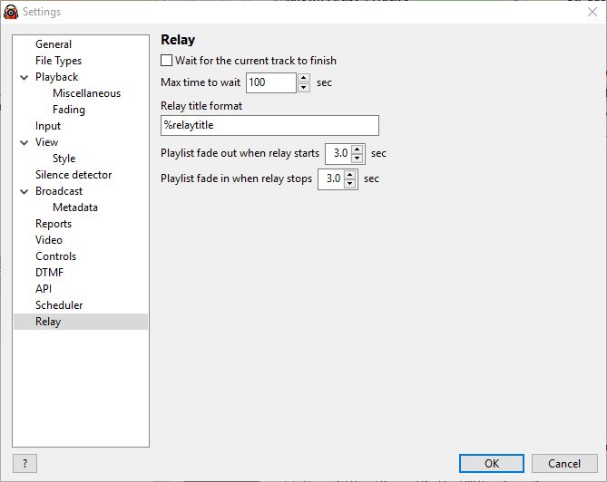

in my RadioBoss 5.8.5.2 Relay Settings is like attached photo,
fading (in and out) isn't working at all !
You can try updating to the latest RadioBOSS 5.9, it has some improvements regarding the relaying.

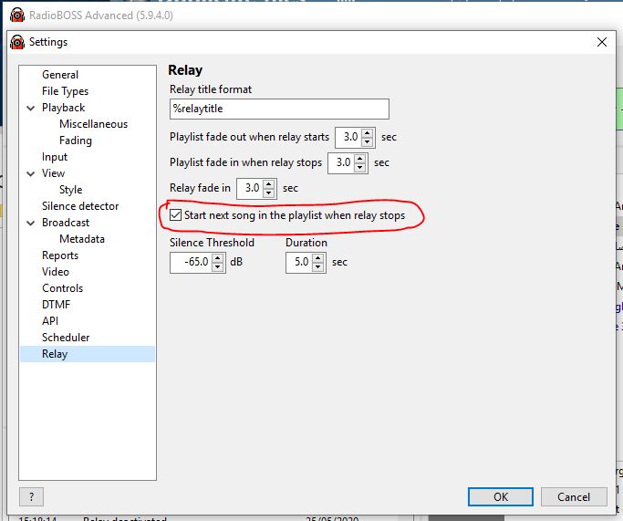

I tried version 5.9.4.0 (trial mode), as you can see in the attached photo, Start next song in the playlist when relay stops is Activated, but I don't know why it's not working when I stop the relay using command: relaystop, the app switches to the current playing file not in the beginning of next file
Am I doing it wrong ? or it's a bug ?
It works only when the relay is stopped (e.g. a network stream it was relaying became unavailable) - not when you stop the relay using the command.
If you use the command, you can add the next command to also switch to the next track.
