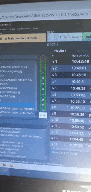

I'm having problems after updating the "MIC" button. When clicking, the program freezes the screen for 1~2 seconds then the music is lowered. I'll make a video and send it to support.

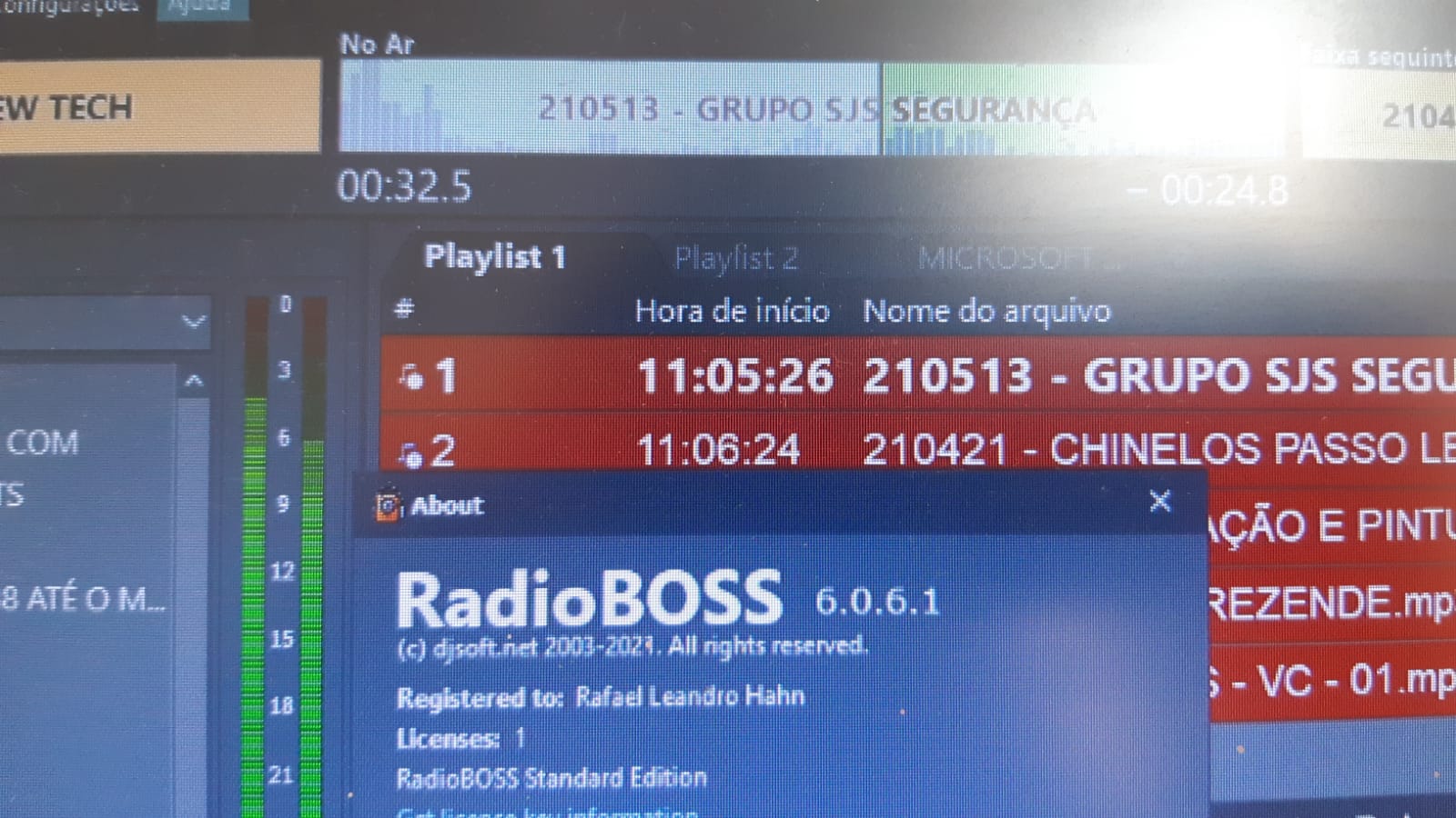

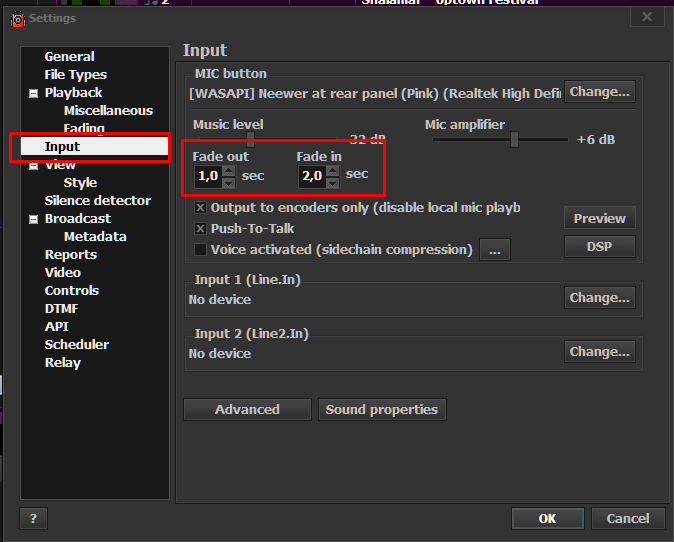

Can you please specify, the music level is not changed at all, or it changes abruptly, without fade? If the latter, please try a larger fade value to see if this is actually the case.
Dmitry, I found my mistake. Push-to-talk option was activated. Of course, on short click nothing happened.
