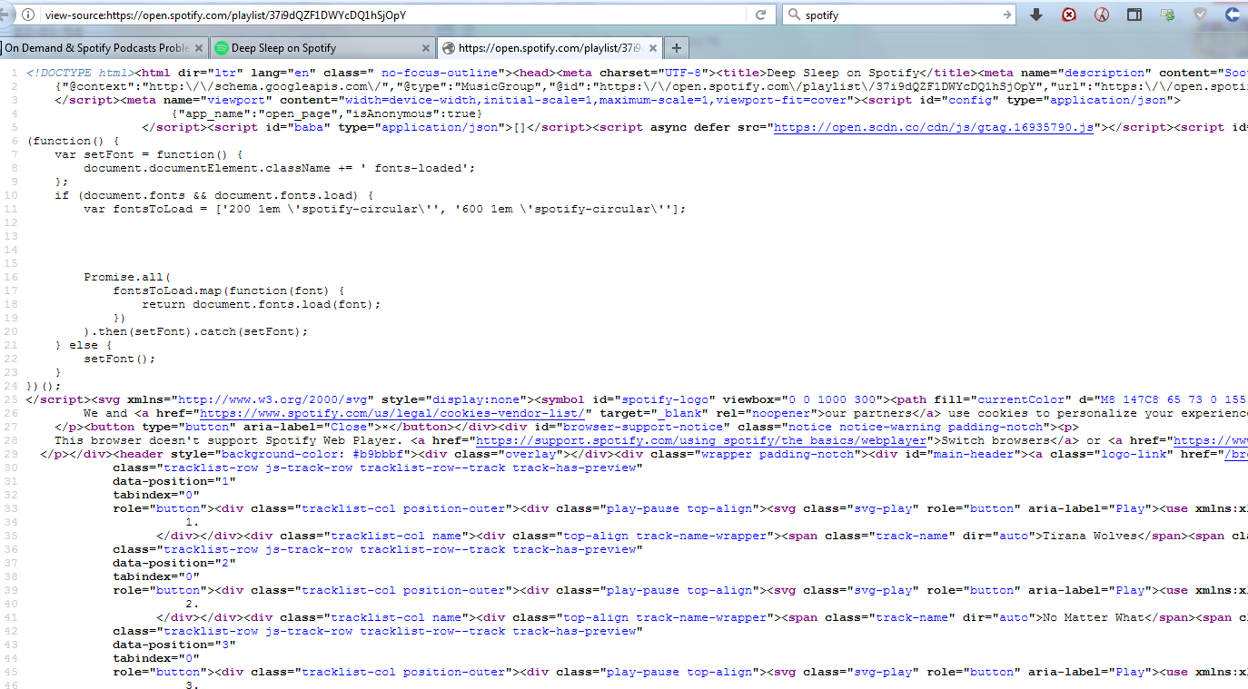

this is a typical screen that you will see when you view the page source
now your job is to try to work out where the bit is that is right bit that would work in radioboss, its like a needle in a haystack, sometimes its obvious, but mostly it is very well hidden, the page designers dont want you to find it
you are probably looking for something that contains the text RSS, or maybe mp3, or XML, or...
this is a TOUGH task
