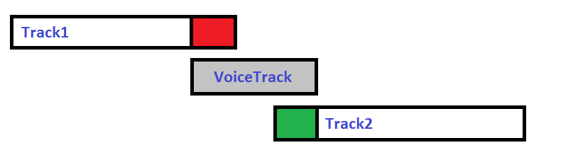

The intros work great with voice tracks, but the outro's do not work when coming from a song with an outro into a voice track. I have the latest version of RB.

Could you please give more details on this? what do you expect from it and how it works.
It would be great if it worked just like the intros do for voiced tracks. Currently if you have a 30 second voice track and a 15 second song intro, RB plays the first 15 seconds of the VT and then comes in with the musical intro of the song while playing the last 15 seconds of the VT. (Which makes it perfect for station automation.) It should work the same way with outro's. Lets say a song is playing with an musical ending trail of 10 seconds and a VT is set to play next in the playlist. The last 10 seconds of the songs should fire the VT off so that the VT and last 10 seconds of the song are playing together.
It works the same way with Outro's too.
Please see the picture attached, this is how voice track is mixed. Red part is Track1's Outro, green - Track2's Intro.
