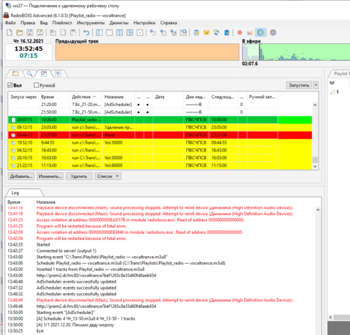

hi i have a problem
#it keeps saying Problem sending data to a server. Please check network upload speed (Output 1)
my download is 19 and upload 1 and a half
can you help
cheers
Streaming requires stable and high upload speed. 1 mpbs is not enough to stream reliably, especially if you use computer for other purposes that depend on the same internet connection (e.g. browsing the web). RadioBOSS detects slow upload speed and notifies you about this problem with the Problem sending data to a server. Please check network upload speed (Output 1) message.
wireradio said:
Is there a way we can ease or help this matter
If your upload speed is only 1 mbps then you should change your ISP or ask them to increase the upload speed.
Sending data to a server is slow. Please check network upload speed (Output 1)
Note My speed 1 GB up -1 GB D/L
Speed test Download 817.75 Mbps Upload 828.71 Mbps our ISP TELL US WE HAVE UNLIMITED ACCESS
If you see this message it means that the speed is not enough to sustain streaming. Speedtest is connection to the server that's near you, while the server you stream to may be far away, and you have different connection speed to it.
Anyway, there's nothing that can be done from RadioBOSS to resolve this. It only detects the problem and lets you know about it. It does not cause it nor it can fix it.
