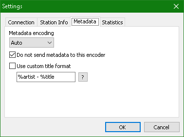

As I said before, we do not use encoders to send titles. It is disabled.
Titles are sent to website and apple app through REPORTS
Please see it here:  https://youtu.be/LjvFVb1jQ9I

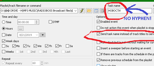

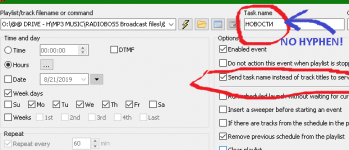

I am talking about this line  http://yoursite/httpreq.php?artist=%artist&title=%title
It has nothing to do with streaming titles to server.  It goes directly to the script httpreq.php
and then displayed on the website.
The names of songs show up correctly - it means that all is done properly BUT
The problem with ADDED HYPHEN starts only when SEND TASK NAME TO SERVER in scheduler is enabled.    please see the image.
Obviously, when this option is enabled, it ads an extra character to the name. WHY, I do not know.  I am asking you to figure it out.
Thank you.
