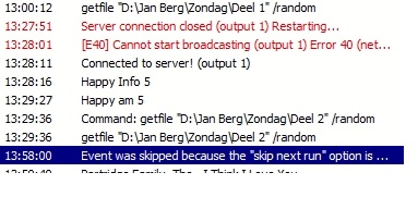

i get these messages once or twice a day and then my next event is cancelled .
Event was skipped because the "skip next run" option is enabled: algemeen.wav line2.in #3600
anyone have a idea where it comes from ?

I appears that you have used the Run Now button previously to start this event, and the next run is skipped. You can turn this off using the menu ("arrow" button) near the "Run Now" button.
