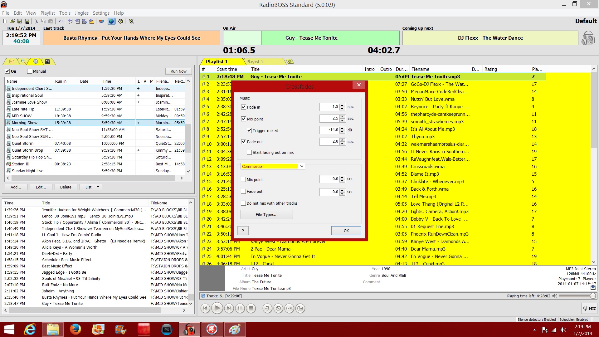

I have noticed since upgrading to Radioboss 5 (randomly) tracks in a playlist will start to play then suddenly skip to the next track. This is happening frequently enough that a 4 hour, 8 hour, etc. playlist will end up running short.
Is there a solution for this?
Thank you in advance.
File attached.

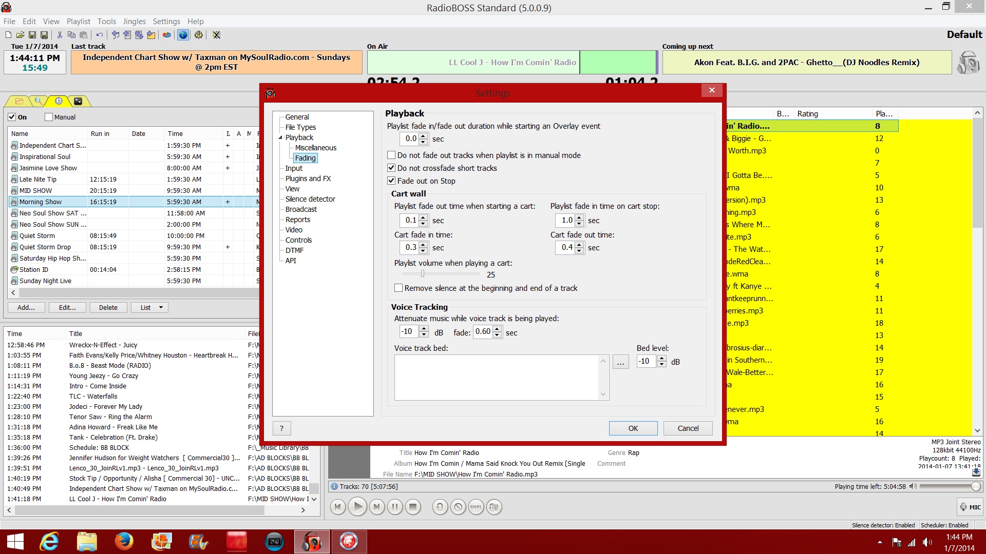

Could you please also send Crossfade window screenshot (in the menu Settings->Crossfades).

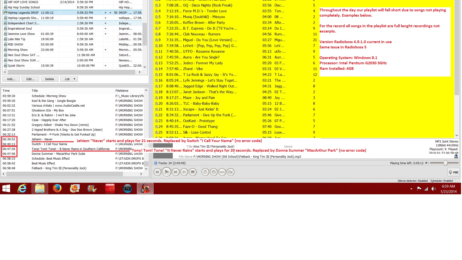

I'm reporting that tracks are still skipping in the RadioBoss 4.9.1.0 and 5. I have attached a screenshot to help you see my concern.

If you play those tracks again, they play to the end, or are still skipped after several seconds?
In the first post you've said that tracks are started to skip after you installed v5, which meant that they played fine in RB 4.9, but in the last post you said the tracks are skipping in RB 4.9 as well... Maybe something has changed on your computer which now leads to incorrect RB operation - did you install any new software (antivirus?) or maybe you added/changed something in hardware?
I'd also suggest you to perform virus check.
All the tracks are full length in the playlist that are generated. And yes, the tracks did play fine in 4.9 when our operating was Windows XP. We have a new computer running Windows 8.1 and now we have this ongoing issue.
