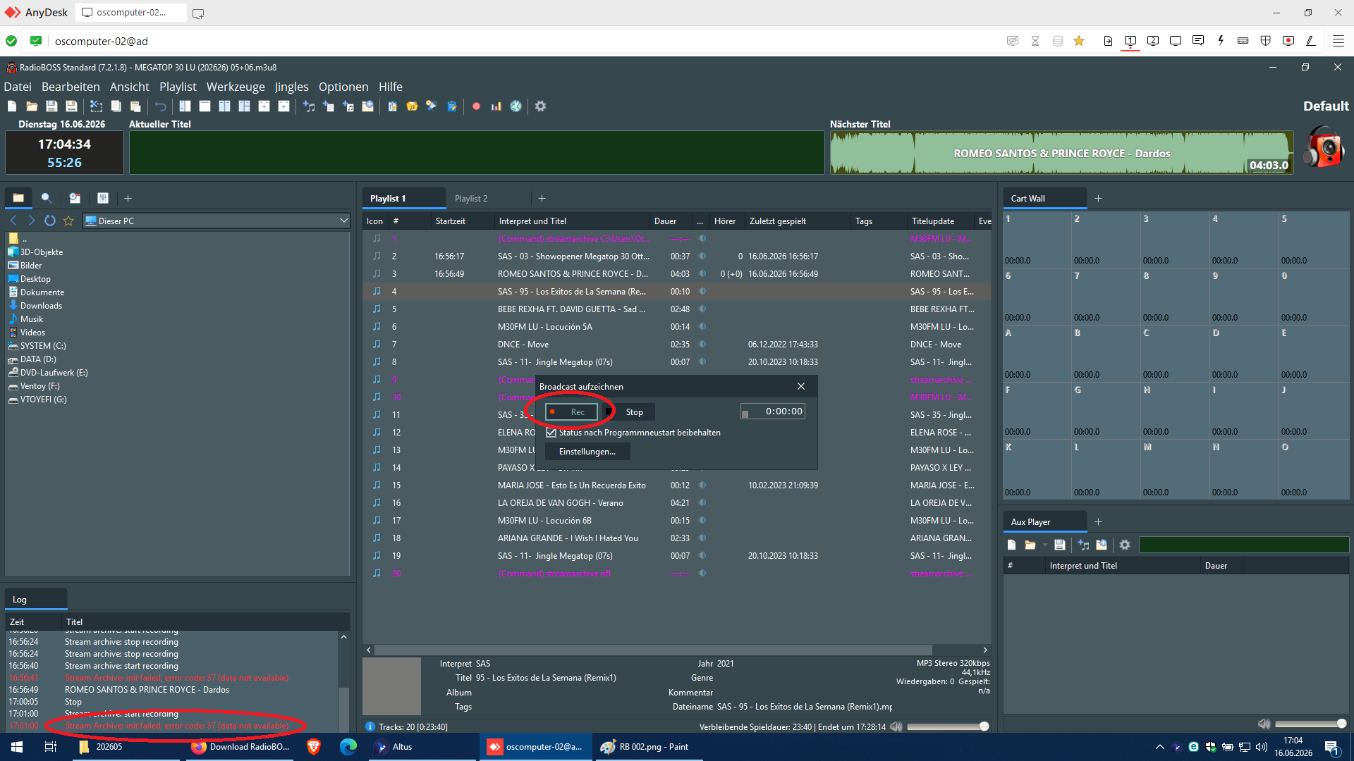

The Streamarchive function to record the played show (NOT WORKS) in this version 7.2. From Audio mix it works but not for Input1 / Input2 etc.

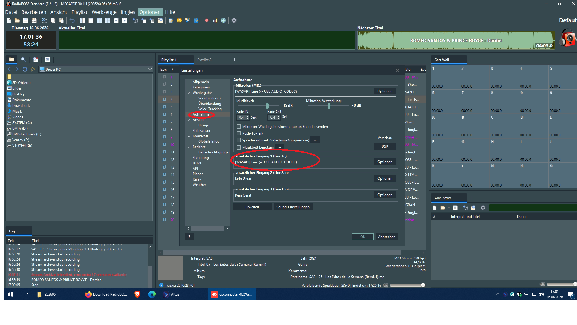

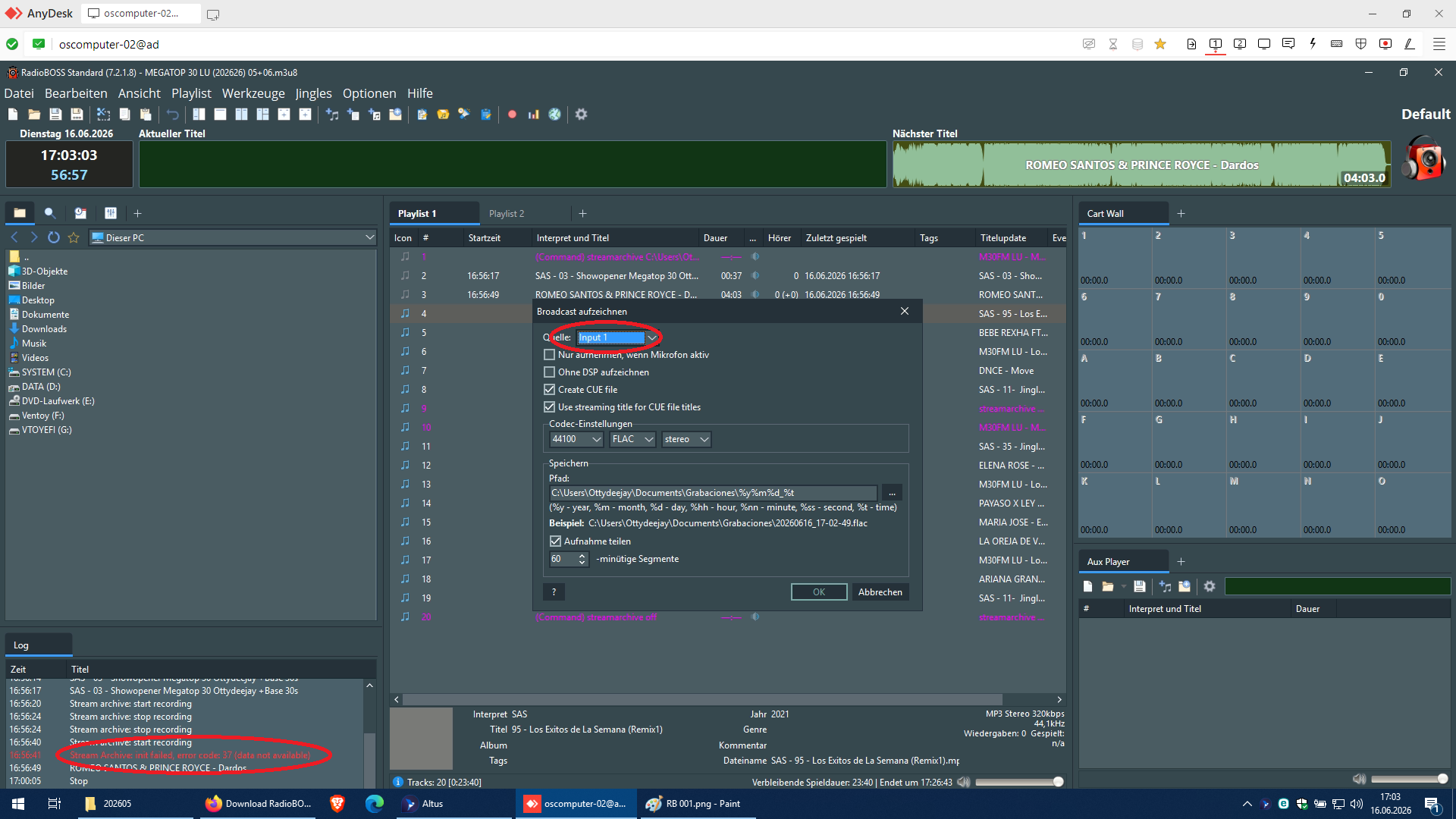

Please send a screenshot of the configuration. Does the input play if you add it directly to the playlist (menu Playlist > Add Line In)?
Here i send you the screenshoots. Same configuration i have it on v. 5.4 and 6.3.3 and it works fine. But on version 7.2 the give error.
Why this works perfectly at the old versions and not at the new version?

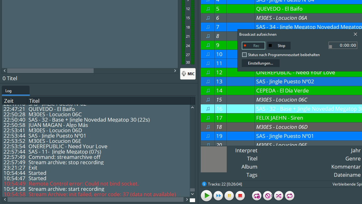

Can you please copy-paste the entire error message?
Here is the message. It's the same that shows at v7.2.1.8 (nothing has changed in the new version)

What error message does it show? The main problem is that we were never able to reproduce this, Stream Archive works as intended, and we don't see any reports of it not working from other users.
The error was the same Stream Archive Init failed error code: 37 (data not available). I can give you my anydesk Access and you can seen it on the fly. I use the same configuration in v5 amd 6 an there works but in 7 no! Please help
At new Version says: Stream Archive Init failed error code: 37 2 (data not available)
