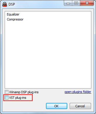

D djsoft Well-known member Staff member Feb 2, 2014 #2 Open Settings->Plugins and FX and select the folder where you have VST plugins installed. Then in the main window add DSP and check the "VST plug-ins" checkbox. Attachments 2014-02-02_12-20-46.png 16.1 KB · Views: 804

D dgrimm New member Feb 2, 2014 #3 No matter how I do this, can't get plugins to show up in list. My plugins are 64bit, would that make a difference?

D djsoft Well-known member Staff member Feb 2, 2014 #7 dgrimm said: No matter how I do this, can't get plugins to show up in list. My plugins are 64bit, would that make a difference? Click to expand... RadioBOSS is a 32bit application, therefor it can use only 32bit plugins. dgrimm said: Can the same plugins be used on the mic input? Click to expand... Not yet - currently MIC DSP's are limited to only internal DSP's.
