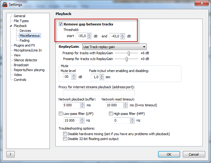

It depends on where your "dead air" comes from. If there's a silence at the beginning or end of the tracks - it could be removed automatically: Settings->Playback->Miscellaneous->Remove gap between tracks (please see the picture attached).
