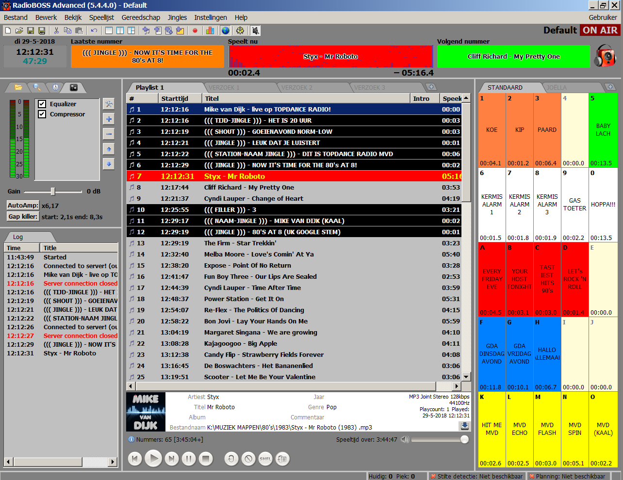

In this case it shouldn't start playback, instead it should show the "Unable to connect" error message. Can you please send a screenshot of RadioBOSS window when it incorrectly started playback?
I have been testing the function, however without succes.
I have made a screenshot a few minutes ago.
Thanks
Mike.
It shows that it connected successfully, and then immediately disconnected. As it was connected, the playback was started.
