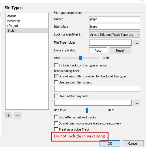

Please add a feature to not include files in %next variable for file types.
The Next Song variable is pretty much useless if it shows Jingles and stuff.

Could this also be added to the "playbackinfo" API so that i would skip certain file types and show the song that's after a jingles for instance? Currently it shows the jingles in the "nextrack" response.
Currently you can use getplaylist2 API to get playlist items, the response includes FT_IDX for track that indicates file type, the indexing is a bit special: FT_IDX = 2 - first file type, 3 - second file type and so on.
