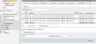

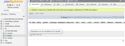

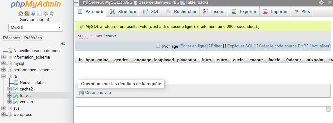

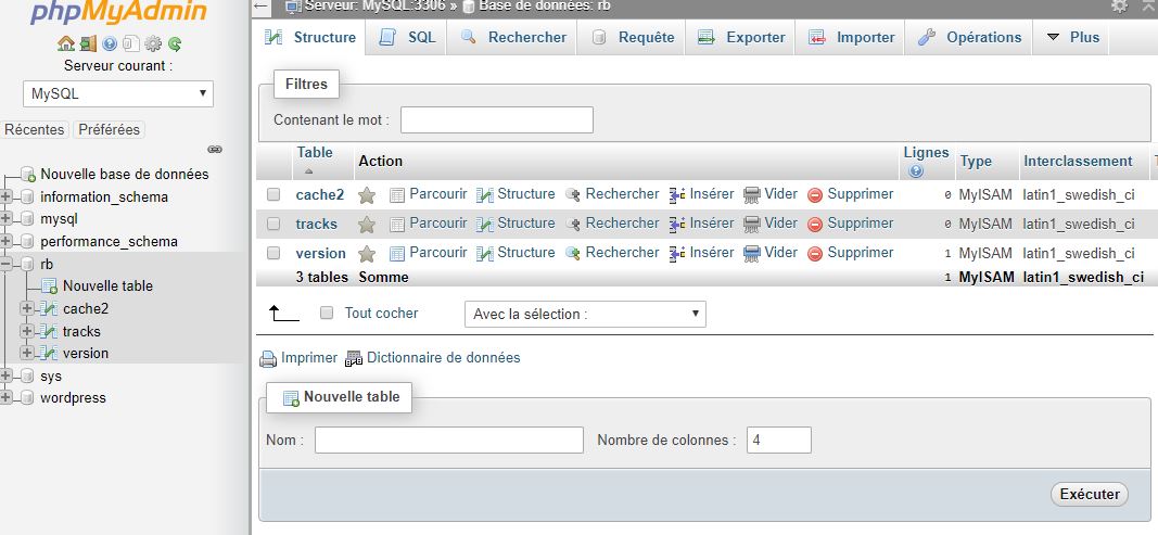

Il fait bien l'installation d'une base de donn?e. (See capture)
But I still have an error message:
[2019-10-22 16:37:42] The key is too long. Maximum length: 1000 (1071).
Would you have a solution?
Cordialy
Please try deleting all the tables and database and run RadioBOSS again, it will recreate everything and it should work. The database should use InnoDB as storage engine, not MyISAM.
This is database name (where RadioBOSS will create its tables) and it must be a valid MySQL database name.
