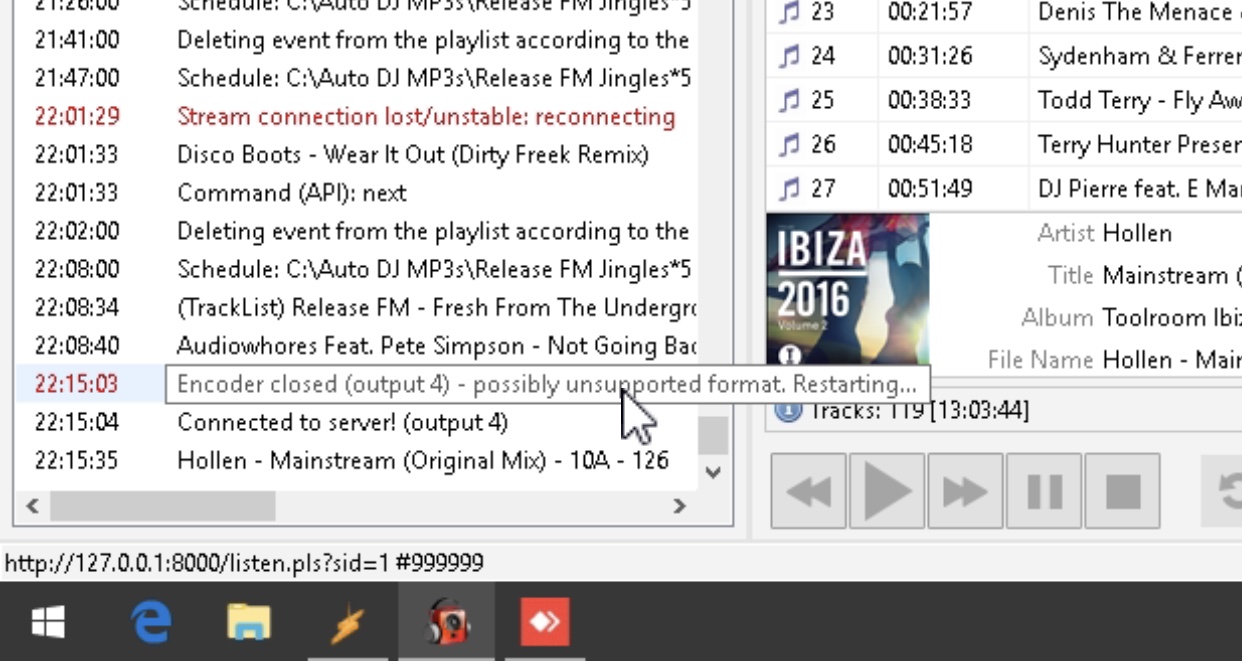

How can I debug the AAC+ encoding? One a day or sometimes more, the encoder has problems and so the stream is restarted (see attachment).

According to the error message, the problem is with the connection to the server, not with the encoder.
Hmm I?m not convinced - we have two connections to the same server, the mp3 encoder didn?t go down at the same time. This issue only ever happens with the AAC encoder.

There are no logs for encoders. Encoder errors are listed in RadioBOSS as "Encoder failure" - the error message contains the word "Encoder" when something's wrong with the encoder. In your case the error message clearly indicates network problems.

And the error does have the word 'Encoder' in it! Check the screenshot again :) We are using AAC+ @ 128kbps.  I've noticed the included ffmpeg version is pretty old now (3.0) can I simply replace the exe?

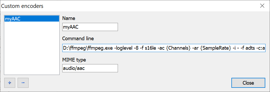

You can use your version of ffmpeg with the Custom Encoders feature: https://manual.djsoft.net/radioboss/en/broadcast.htm. The command line will look like this, please also see the screenshot attached:
Code:
C:\path\to\ffmpeg.exe -loglevel -8 -f s16le -ac {Channels} -ar {SampleRate} -i - -f adts -c:a aac -b:a {Bitrate}k -cutoff 20000 -
It works with the latest ffmpeg 4.2.2 download from https://www.ffmpeg.org
It appears that it does not support HE-AAC, but as you stream at 128kbps, you don't really need it.
