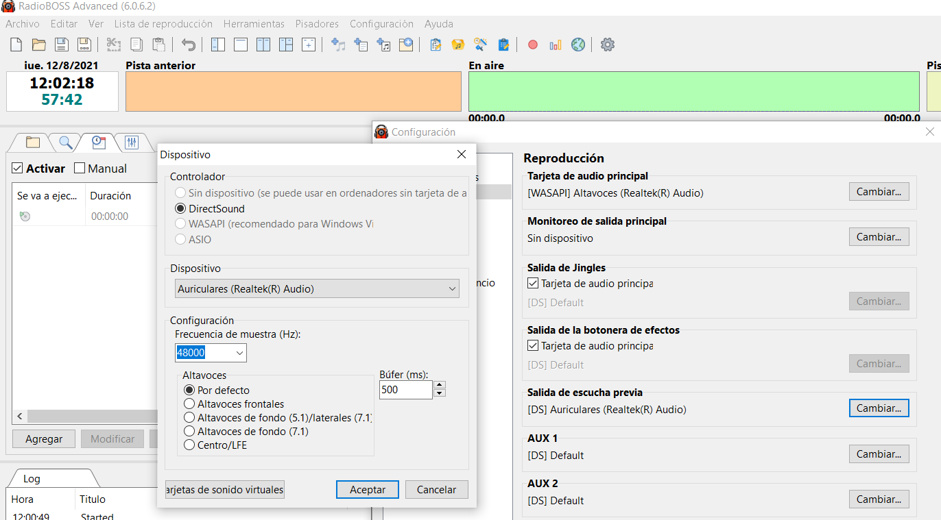

The difference I think has to do with the directsound buffer. It is approximately 500Ms. If I lower the audio buffer to 150ms, it is barely ahead of it yet, but it is much better.
With 50Ms, in direct sound the audio is choppy, so I could not test it.
It accounts for the buffer size, so it should be more or less accurate. A quick test here does not confirm the problem, can you please try with another device?

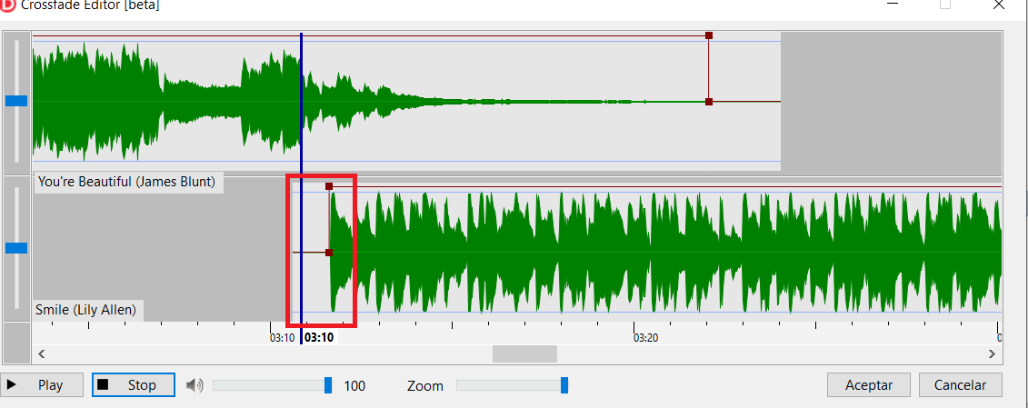

but there is a case in which the difference is 1 second!., When the preview starts at a point that track number 2 has already started (see screenshot)
If a point is selected before the start of the 2nd track, the difference is usually about 200 ms.
The difference is only between the cursor position and the sound actually heard? In this case, what happens when playback is just started, there's no sound and the cursor moves? Or sound starts immediately but it doesn't match what the cursor shows?

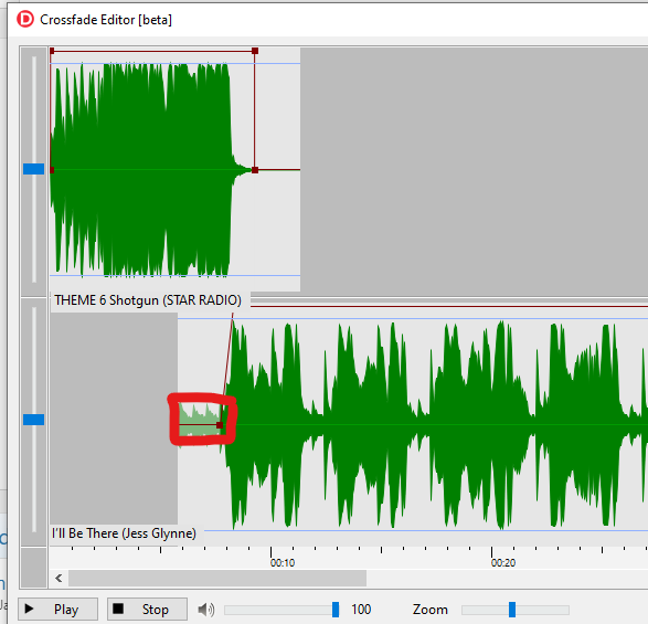

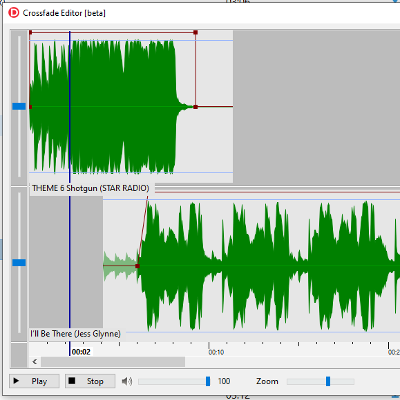

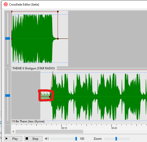

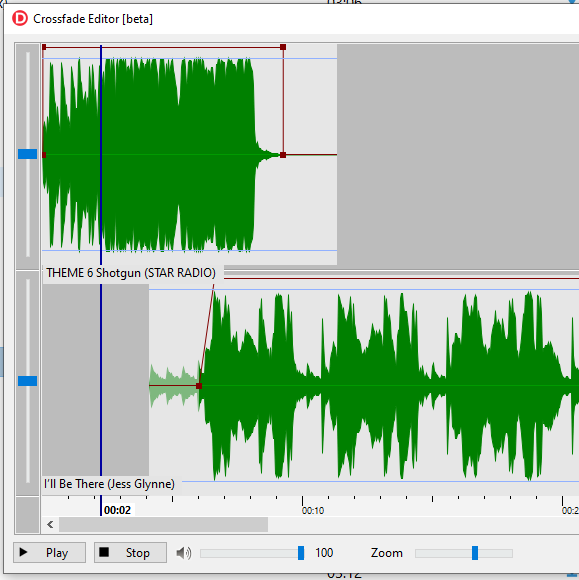

I have also noticed a bug which only happens when you use the first fade keyframe that choses when the track starts:View attachment 11216
, I'll set the track to start like that, but when I click OK, and open it again, then the bottom track shifts to the left:
meet random anonymous, If I correct it again and click OK then it seems to work but it doesn't work the first time round :)
