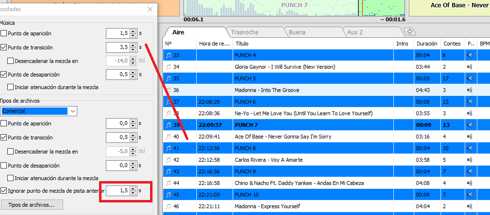

There is a problem with the mixture in the file types.
When they are inserted as in the picture attached.
If in between each file type there are two normal tracks mixing time is correct.
I am using "Ignore point of mixture of the previous track" (which has a high priority) to change the time of mixing of normal tracks. (It would be 3.5 seconds to 1.5 to not overlap with the type of file)
The problem is that this configuration is also changing the time of mixture of the same type of file.
In the picture you can see, the track "7 Punch" air is a type of file that you should mix 0.5 seconds. In its place is this mixing 1.5 seconds and this is a mistake.
"Ignore point of mixture of previous track" for the file type you are applying.
Again: the idea is to apply on normal tracks so that its end is not so long, and do not overlap with the beginning of the file type.

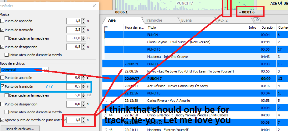

I wouldn't consider it as a bug as it's the way the feature designed - it overrides the mix point to the set value.
An option can be added, e.g. "Apply to music tracks only" - when enabled, it will override mix only for tracks that do not belong to any file type. How does that sound?
"Ignore previous mix point" also ignores the mix point of that same track (which is this type of file,Which is being reproduced)?
No - it only overrides mix point for the previous track. You can press Ctrl+D to see the actual mixing time.
Then it works exactly as I thought it would.
The track "Punchi 7" (that is being reproduced) is of the type of file "Comercial"
Should end with a mixing time of 0.5 seconds. Instead of 1.5 seconds
