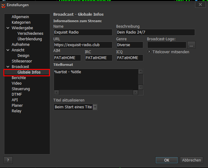

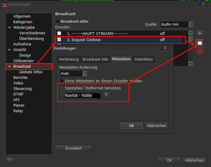

Ok thanks, How to pass meta data from radioboss to stream url?
