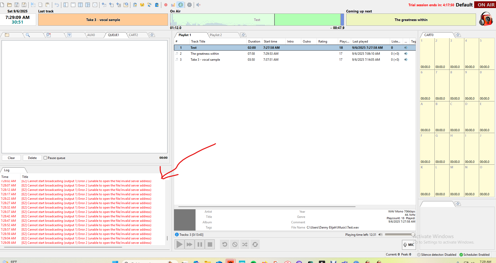

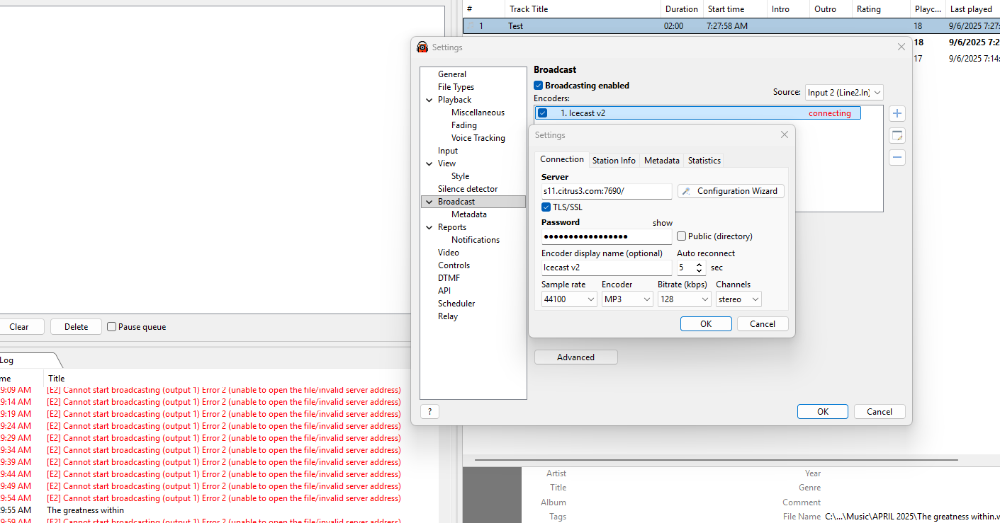

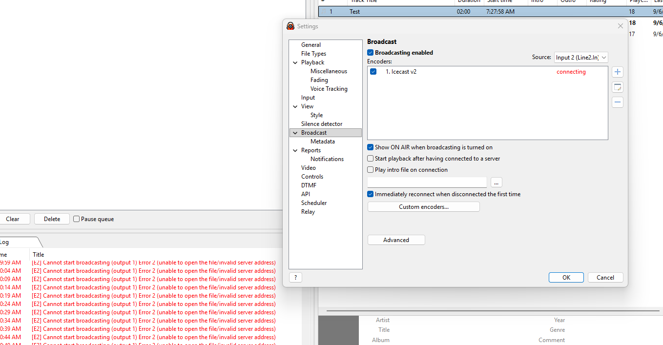

Hi, I have tried everything according to the instructions and even contacted Citrus 3 for support and they reset my account and gave me further instructions and yet I still can not connect. What am I doing wrong?

Looks like the mount point is missing in the stream URL.
In the server adress after s11citrus3.com:7690/HERE SHOULD BE THE MOUNTPOINT
like this radioboss-forum.de:8888/live5
There should be no slash in the server address field. Also, mount point is not specified.
