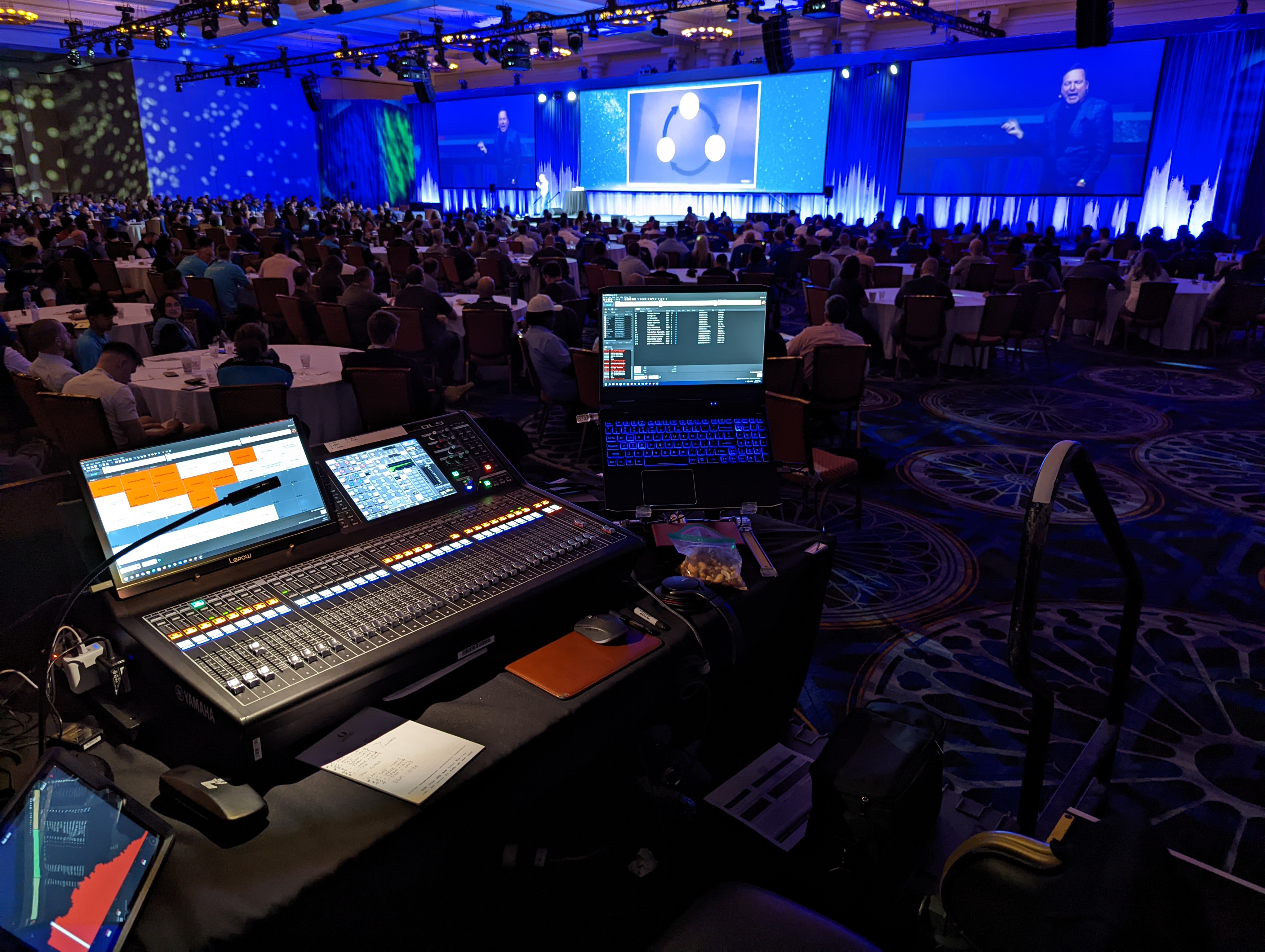

The track tool definitely doesn't work on the cart wall tracks. I am using the 64 bit version on 2 different rigs using a Scarlett 4i4 interface and win 11. Both machines are brand new with very good specs. Using RB 6.1.1.0. I have tried using the headphone and speaker outputs also with the same effect.
I posted this bug over 2 months ago and still haven't gotten a notable response from the dev team other than we'll take a look.
I've used this program professionally for years and I never use it for streaming. I am a live music and corporate audio engineer so being able to to cut tracks inside the cart wall on the fly where I'm playing stingers and VO's to large crowds is something that would help me and other engineers that use this program for live events and meetings very much.
I am able to use the track tool within the playlist tabs without issue, on the cart wall tabs it just doesn't work.
Here is a pic from my gig this past week using 2 instances of this app. One for background music and the other for playing voice overs and stingers for talent.
