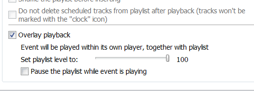

I will shortly be running a news feed at the top of the hour.
I think, I have worked out how to do this by running a number of schedules one after the other but was wondering if there is an easier way - via a "playlist" created using PLG Pro ?
1. Play News Intro (at the end...)
2. Play News Bed (3 minutes long...)
3. Play news feed from external file source over the top of the news bed (At end of feed)
4. Play news outro - terminating the news bed before the outro starts
Creating a single playlist would be easier to schedule rather than 4 schedules one after the other

Yep that is easy to do but what I am looking to do is overlay the new bulletin on top of a bed.
I can see how to do that within a schecdule event but not how to compile that into a playlist
See image below

I'm afraid it's not possible... When you play a playlist all tracks are played in sequence, one after another.
You can try this approach (untested):
1. copy News Bed file to Voice Tracks folder
2. for News file in the Track Tool set "Intro" to the end of the file
3. the plylist will look like:
- Intro
- News Bed (from VT folder)
- News
- Outro
There's a limitation that News bed and news should have same duration.
I think you should prepare a news file (mix news file with bed) and play it as usual.

If I create the intro + Bed + outtro as a single file and run that as a schedule then - a few seconds later - call the news bulletin and "overlay it" ? that would work ? - I think ?
It will work, but there's a synchronization problem. The news file duration have to be the same as bed duration, so when news track ends, the "intro+bed+outro" playback should reach a point when Outro is started.

Once my subscription starts to the news feed I will have to test it properly. The news bulletin is exactly 3 minutes long so I would have the bed length say 3:05 to allow for buffering. the news bulletin is simply called from a permalink so a simple http request
I do have the option to download the file by FTP and process it but that would mean setting up other schedules and running other processes in the background - more things to go wrong !
If news is exactly 3 minutes that makes things easier. The approach with two events will work.
I was checking request list and found a similar one: add bed for file type. This will be useful for news, automatic weather/time announcements and maybe something else.
Expect this feature in one of the 4.9.x updates :)
