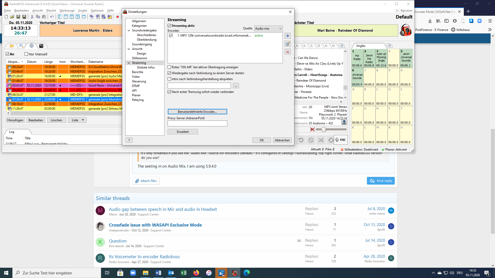

Yes thats how it supposed to be, but when I enable the Output to encoders only" I dont hear it myself BUT its also not streamed

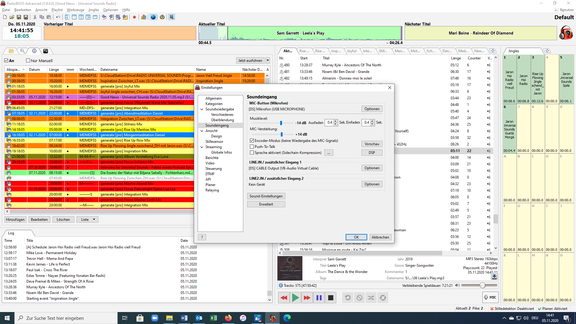

When I speak in to the mic (mic activ) and the Encoder-Modus is activated (as in the print screen below) , I see in the "green" equalizer still the sound input from my voice, but its not broadcasted. When the Encoder-Modus is not activ, the voice is broadcasted.
