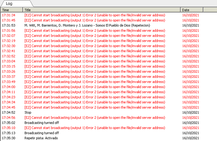

Hello, I'm having an issue with RadioBoss 5.9.2.0 ...
The program stop work today after more than 2 months working without problems.
I'm getting this error:
[E2] Error 2 (unable to open the file / Invalid server address)
I reinstalled the program... I rebuilt the music library, I reconfigure the servers from the beginning.. but still not working.
This error means it can't connect to the streaming server. Please check the address and port, and also check that the server is accessible.
[SOLVED] ... the radio server uses DJ account to interrupt the AudioDJ and take the LIVE streaming... I had 3 DJ account... maybe one was stuck and the server didn't allow me to connect...
At the end I deleted all the three DJ Account, create one brand new.. and than the server connect and work properly.
