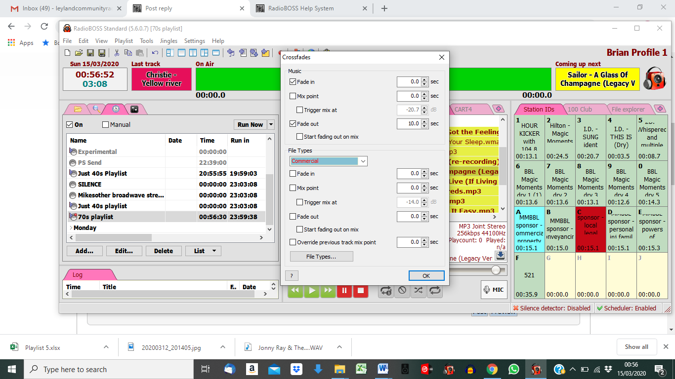

Thanks for this but it's not obvious how that is the case.  I'm using 5.6.07.
The Crossfades section of the manual does not give enough specific information to explain how to do this. Are the two playlists concerned recognised as Music in the Settings/Crossfades dialog? Or do I need to add a File Type category "Playlists"?
A worked example showing settings in the Crossfades dialog would be helpful. I'd like the first playlist to fade over the course of ten seconds, with the second playlist then kicking in at a pre-scheduled time. The settings given in the attachment result in the second playlist starting without the first playlist fading out.
What, please, am I doing wrong? TVIA
Evety track that does not belong to any file type is considered as "Music". On youre screenshot, there's no mic point (meaning no track overlap) and also no fade in - meaning tracks will start at full volume. This means hard transition between tracks.

There's fade out setting to make it fade out, and Mix that controls track overlap. Please try different options to see how this works for you. In your current setup, you have turned off Mix so there's no overlap and next track will start only after currently played track faded out to 0.
Yes, as shown, it's set to a 10-second fade out but unfortunately, the playlist doesn't fade out.
Yes, that's exactly what we want - for playlist 1 to fade to 0 and for playlist 2 then to start. Unfortunately, playlist 1 doesn't fade to 0. It cuts out dead.
Try inserting a fadeout 10000 command at about 59:48.  PLaylist 1 will stop after a 10 sec fade at 59:58, there will be a 2 sec pause (silence) and playlist 2 will kick in at TOTH.  ;)

It should fade out, unless the playing track belongs to some file type where fade out is zero, or you used Segue Editor to change fades, or a custom fade out option is set in Track Tool - you can check is this is the case.
