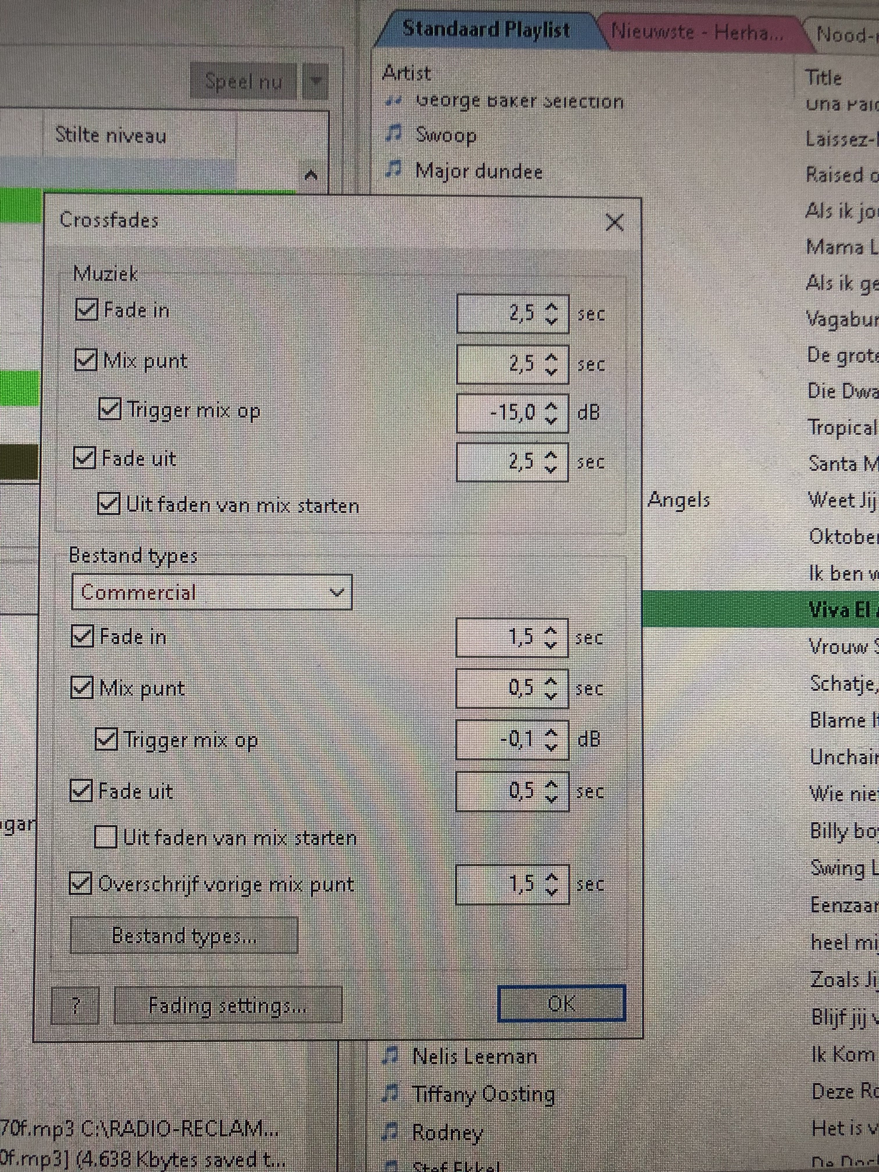

Songs are regularly played halfway. Everything at 2.5 with crossfade. mixpoint 14.5 I've been working on it for months but can't get it right. latest version now too.
1-THIS IS MY CONFIGURATION.
IT ALWAYS WORKED WELL THERE......
2-AT A LOOK AT THE FADE.

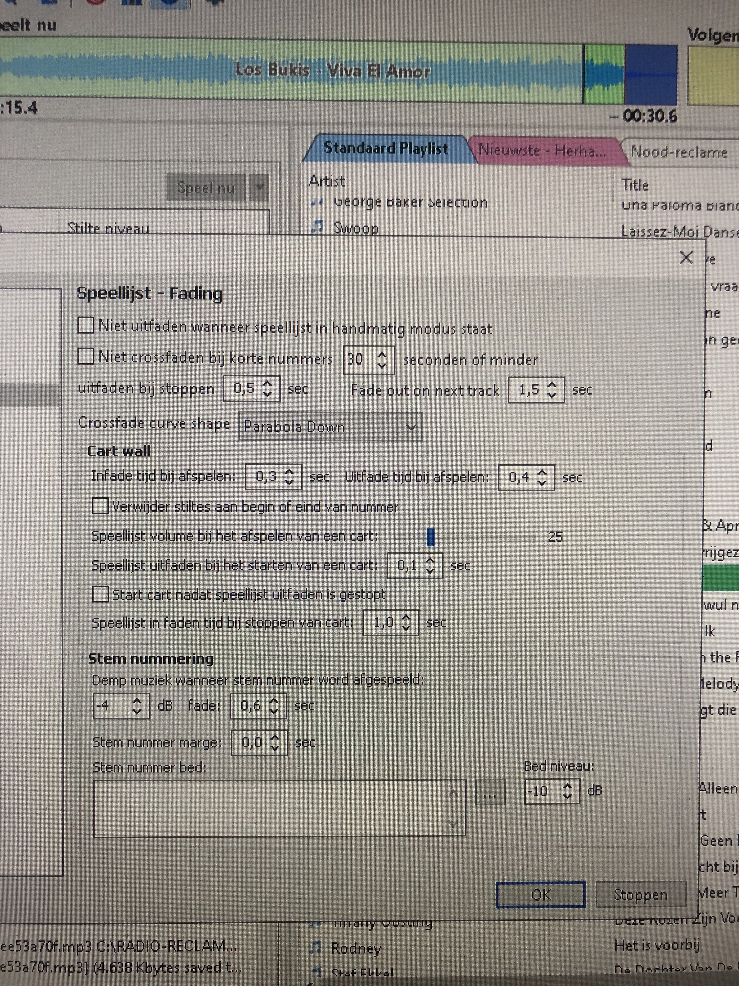

Gap killer off
Check if tracks have End point assigned (right-click in the playlist, Track Tool), also check crossafdes settings, may be you have "Trigger mix at point" enabled and the level is too high, so it causes large part of a track being cut off.
You can try disabling "Trigger mix at" crossfading option. Also check your tracks in Track Tool, maybe there's "End" marker set in the middle.
