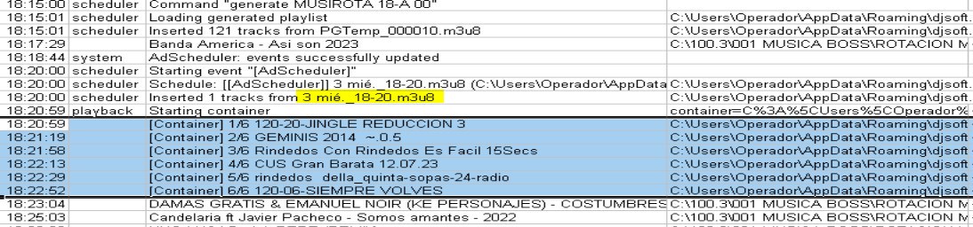

Is it possible to add a column with the playlist name to each record where "Container" is mentioned?
This way, we can identify which playlist the container belongs to
. (highlighted in yellow in my example)
After the playlist is loaded, the items loaded from there do no "know" anything about the original playlist. This is true for any items - containers, tracks etc.
How playlist information would be useful by the way?

You can find it out from the log based on start times - e.g. when container started, and when next track after it started, time in between is container's duration.
Yes, exactly, that's what I was planning to do. However, unfortunately, I still don't know to which block it belongs. That's the problem!

That's why I asked if you could add a column with the block identification to each track within the container.
