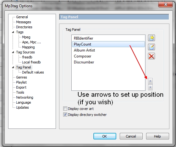

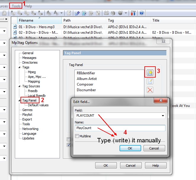

1. In menu bar select Tools -> Options -> Tag Panel
2. In the Tag Panel click Add Field and complete those two field:
  • Field: PLAYCOUNT
  • Name: PlayCount (pay attention at capitals - write it as you see it)
3. Arrange position of the new field with arrows (if you wish)
4. Set PlayCount field as <keep> to preserve data
  • Field: PLAYCOUNT
