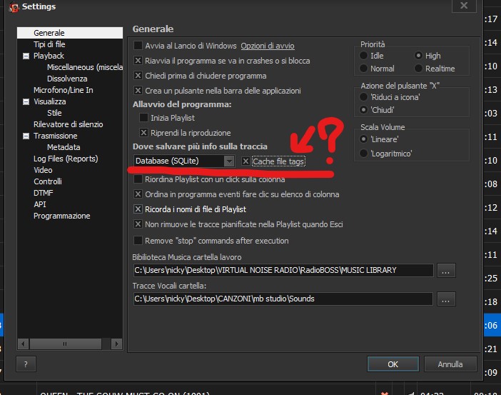

You can switch storage to database: https://manual.djsoft.net/radioboss/en/additional-information-storage.htm
This way, when the file is changed, the information will still be present in the database.
I'd recommend reading the article linked in full to understand the consequences of switching to database storage.
ok, it can work with the sql database ...
Since the information will no longer be stored in the mp3 TAGs, I wanted to understand where this information is saved where I find the file to be able to backup, since it becomes an important file.
If you use the SQLite option, it's saved in the tracks.db file, one directory up from RadioBOSS settings directory (you can open it using the Settings->Open settings folder menu).

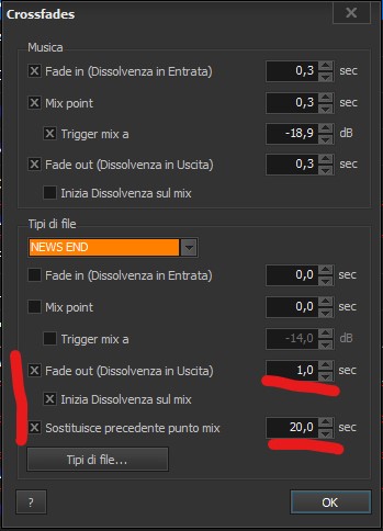

There's a possible solution, though. You can create a file type for your own ending jingle. Then, in the crossfade settings for that file type, set:
- Override previous track mix point - 20 seconds (or how much you want to cut from the end)
- Start fading out on mix
- Set fade out time to like 1 seconds to prevent abrupt ending
Then, you simply schedule your downloaded file, following by a file of the type you have created.

"tracks.db" can not find it in the folder
I find only "TrackList_v2.cache" in the TEMP folder.
What is the use of the "cache file tag" ??

This seems to be a pretty specific use case, so I'm not sure if it will be a benefit for a majority of RadioBOSS users.
I tried to do as you told me, partly works.
In practice, the next jingle starts at -20s (set to the previous track mix point override)
But while in the next jingle continues and also the programming, the track that had to be truncated of the 20 seconds continues, it feels lower but it feels ...
where am I wrong?
You need to go one level up from the settings folder, to the "djsoft.net" folder.
You can find some information about it here: https://manual.djsoft.net/radioboss/en/tag-cache.htm
It should not continue - it should be faded out. Do you use the latest RadioBOSS 5.8?
OK THANKS, is it possible to save this file in the general folder where I have all the files ?? workbook?
Actually I still use 5.7.2.0.
I'm testing the 5.8, and even I do not work well this "Override previous track mix point"
It does not detect it at all, as if no Override point previous track mix point had been set.
with 5.7 it works, but the audio plays in the background
Perhaps the problem is that previous track (the news) has custom mix point set in Track Tool , it has precedence over the override option.
