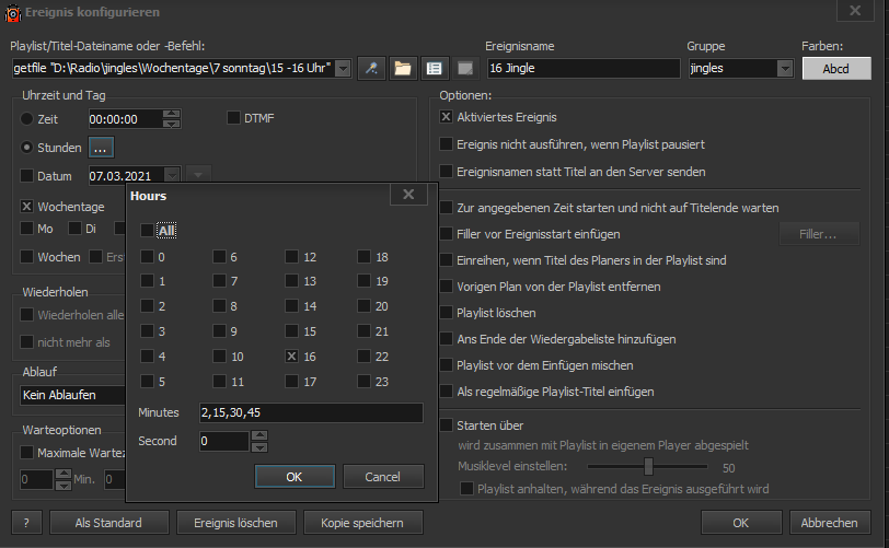

Ich have a weird problem.
I programmed every hour the news, the news take about 2 minutes, after the news i programmed he has to play a jingle at 2 minutes after the news , after this i programmed he must play a playlist of songs So far everything work fine.
Strange thing is he plays the programmed jingle 2 times and then the songplaylist.
I do not know what is going wrong.
You should check the log (bottom left corner) to see what happens there. What RadioBOSS version do you use?
Hi, thank for you question, founf the problem. The news i download every hour was now much shorter than normal, thats why he played the jingle 2 times to fill up missing time
