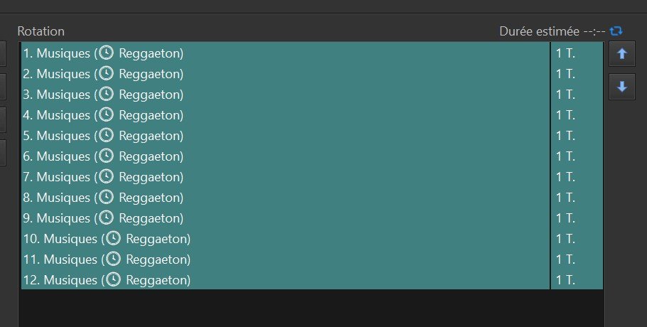

Currently, when we want different variations of the same category (for example: different tempo levels, male/female alternation, language balance, tag boosts, etc.), we must duplicate the same category many times, even when using globalized categories.In some cases, this means creating 10, 15, or even 20 copies of the same category just to adjust small parameters.
This becomes difficult to maintain and makes the Categories screen heavier than necessary.

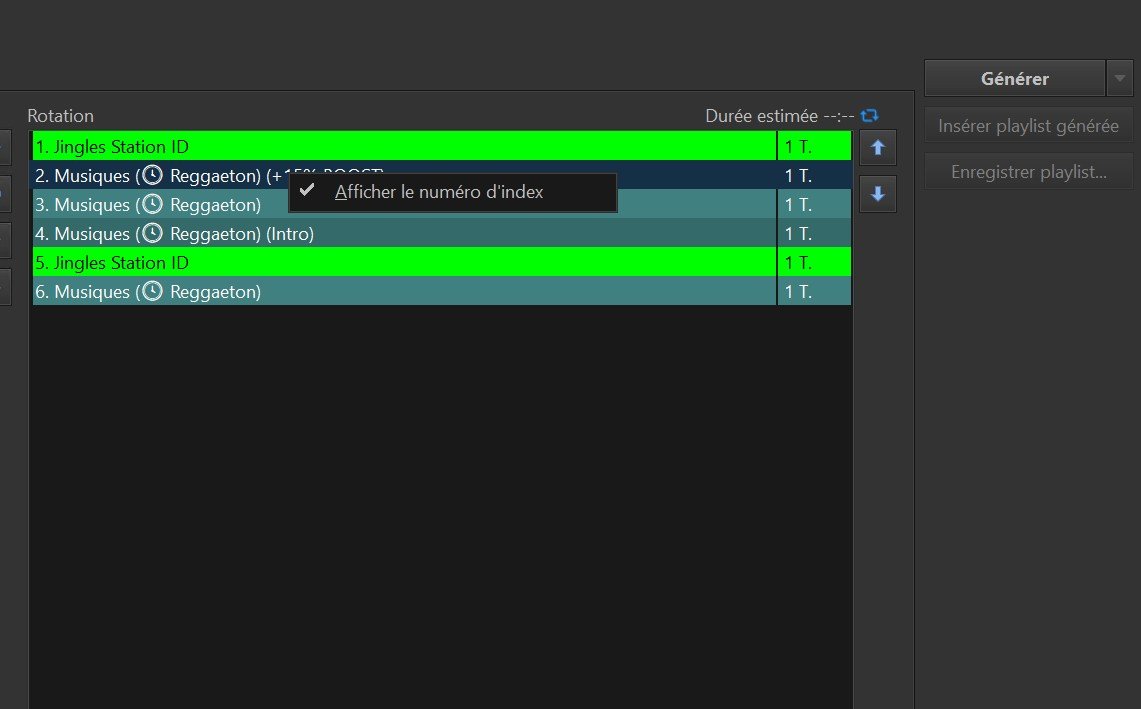

Inside the Rotation window, under each category entry, we could have the ability to:
  • Include or exclude specific tags
  • Increase or decrease tag weight
  • Adjust tempo or energy level
  • Fine‑tune alternation rules (Male/Female, languages, etc.)
  • Boost or reduce specific attributes (e.g., +10 weight for “Boost” tag)
All of this without having to create multiple category duplicates.

We would have one single “Reggaeton” category, and inside the Rotation window we could define:
  • Reggaeton > Rotation 1 → very dynamic, female
  • Reggaeton > Rotation 2 → very dynamic, male
  • Reggaeton > Rotation 3 → less dynamic, +10 weight for “Boost” tag
  • Reggaeton > Rotation 4 → different alternation
  • etc.
This would give us much more precise control over the hourly rotation while keeping the category list clean and simple.

Right now, it’s actually already complicated because we've had to duplicate categories sometimes up to 10 times to achieve this result.
Indeed, if I change the tags or other information in the example given for Reggaeton, I would have to change it across all 10 subcategories that were created.

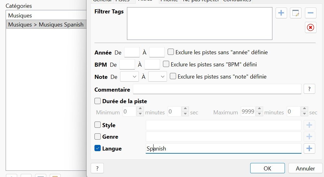

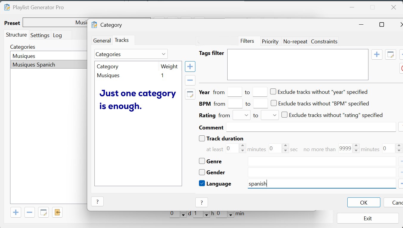

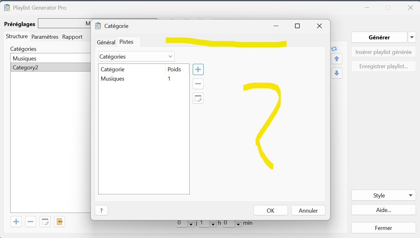

For instance, wouldn't it be possible to define this in the Tracks tab > Select tracks by Category (as shown in screenshot 1).

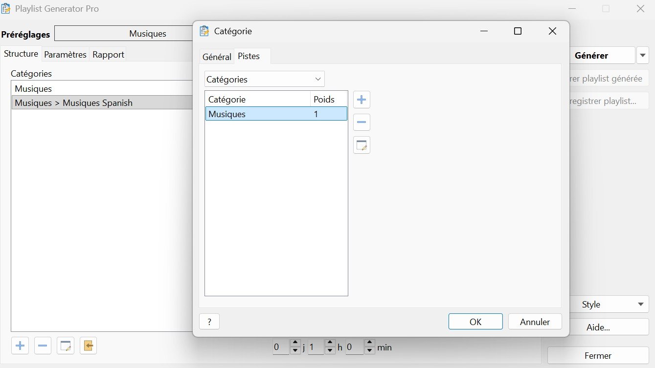

This would apply the initial filtering for the base 'Music' category, and then allow us to add sub-filters, as shown in screenshot 2. If, in screenshot 2, we can once again apply a filter such as 'Language', for example then it becomes easy to create 'Spanish Music' and manage all the music from the initial base music category, and so on indefinitely.
The result would be that Screenshots 3 and 4 are displayed as shown here in the same window to create a subcategory.

This is an interesting idea, do you think such a filter should apply to all categories in the source? Or there should be multiple additional filters for each category separately? I think one filter for all categories in a source is pretty workable solution. Question is what to do with filters already present in the categories themselves.
For our use on national terrestrial media, there are programming requirements and government restrictions that mean the most efficient solution—integrating what already exists—would be to have:
The main category, for example (Music), with all current restriction filters (without modifying anything at this level). This essentially forms the rotation base for future sub-categories, which prevents us from having to re-edit this entire layer simply to add a filter like "Spanish."
Then, this is where it gets interesting: we reuse this "Music" category instead of "Tracks" in the playlist generator by "Category". Here, there is no need to add multiple categories; just putting "Music" is already very good.

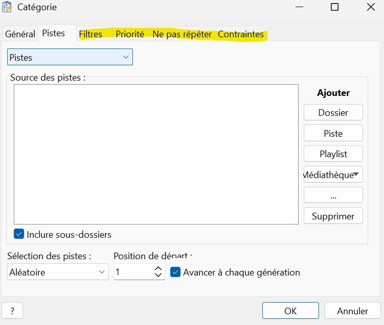

Next, we can apply additional filters. Generally, the bulk of the filters are already in (Music); the idea here is to apply light additional filtering (selecting a language + one or two exclusion or inclusion tags + BPM + YEARS), which will already be quite good. That being said, "he who can do more can do less"—if you could bring back all the tabs (Filters, Priority, No-repeat, Constraints), that would be a bonus.
The idea isn't for the software to spend 4 hours generating a one-hour playlist either, and it won't be efficient for us if it involves generating sub-categories of sub-categories...
On the other hand, it would be highly beneficial if the software could cache the (Music) Category when generating the playlists, in order to easily generate the sub-categories afterward. If the software has to re-calculate the entire path for each sub-category, our servers will struggle during playlist generation. We wouldn't want your recent database generation optimization work to be compromised by this new approach.
But please understand that with this addition, our radio stations could be managed with a level of precision that we simply cannot achieve today. We are truly talking about a major breakthrough for us as professional radio broadcasters.
