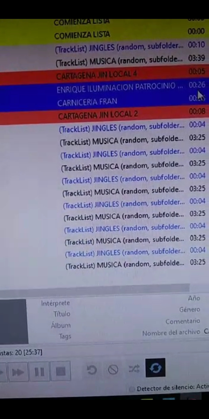

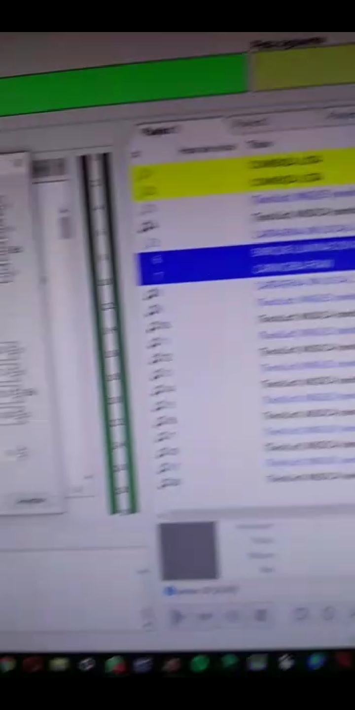

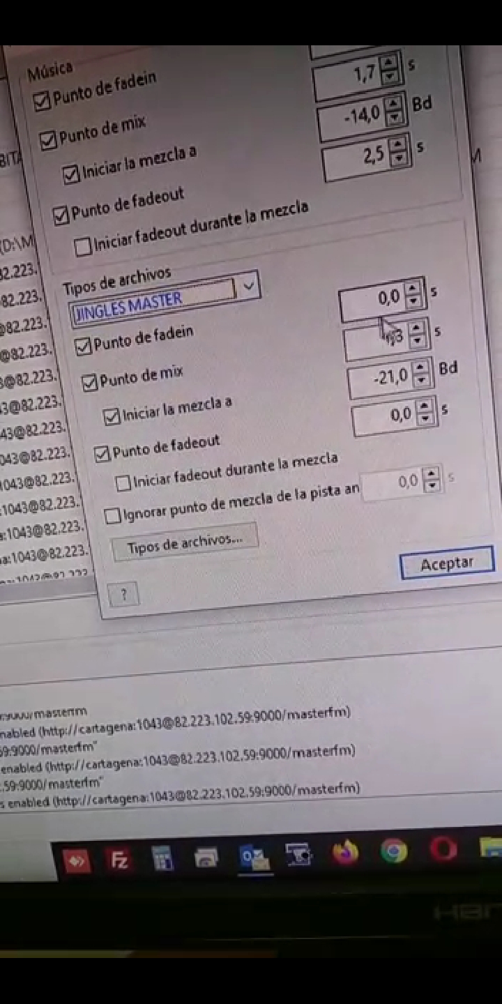

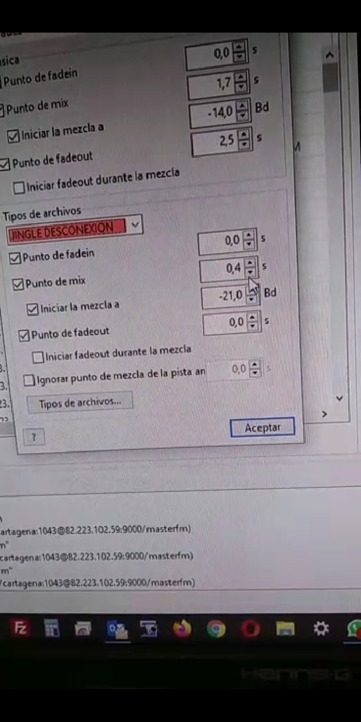

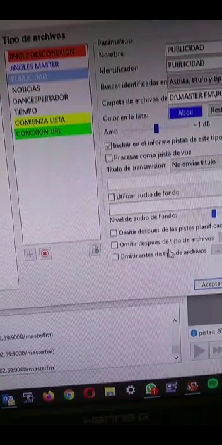

file types and colors never work right.
for example we have normal jingles with 1.3 sec mix. also jingles disconnection with red background and mix 0.4. well within file types only the mix of the one that is first in the list works. that is, if first this jingle is mixed with 1,3 and second is dexconnection jingles with a red background. second jingle does not appear red in the playlist and mixing does not work at 0.4 sec. if jingles disconnect is first in the file type list, if it comes out red in the background and the mix of 0.4 works. It seems that only the first file in type of files works, the other jingles positions do not work. I send a video.

When you use Track List, it only evaluates the next track. To show colors for the other tracks, it does a "draft" track selection and detects file type based on that. When the item is actually played, a different track can be selected, probably with a different file type.
